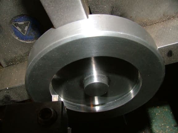

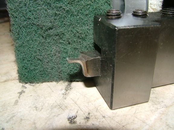

Trepanning is a useful operation that may be thought of as putting a groove in the face of a workpiece on the lathe. The groove may be narrow, a wide recess, or even all the way through to cut a disc out. Trepanning tools are available for mills and drill presses especially for the latter purpose. Here is a sequence Bobstandard published on HMEM showing how to trepan flywheels with a tool he has ground:

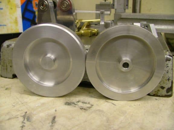

Here are a couple flywheels with trepanned recesses ground inside...

A look at the tool that did the work...

The tool in action...

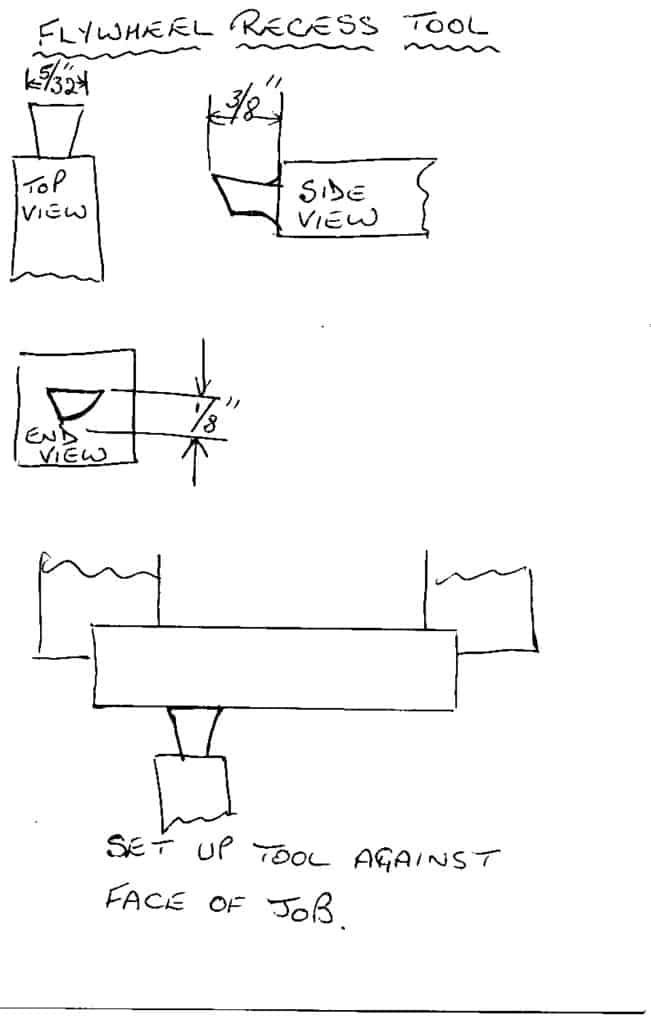

Hand-drawn diagram of Flywheel Recess Tool with measurements and labels.
General guidlines for grinding such a tool...

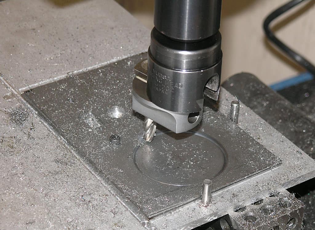

I've tried to grind my own trepanning tools for hole cutting on the mill with some success. I started with a dulled endmill and ground all but one flute off and tried to make that flute extend down as much as possible. I then installed the endmill in a boring head and went at it:
Metalworking tool on CNC machine, with metal shavings.
My trepanning tool ground from an endmill in action...

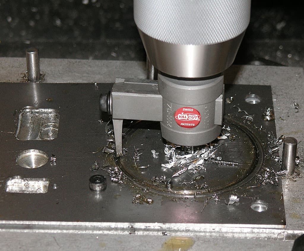

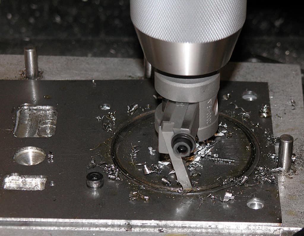

A commercially available trepanning tool of the type I show a cutter for above. It works a little better than the hand ground endmill, but not hugely better...
Swiss-made Valcut drill bit on a metalworking machine amidst scattered metal shavings.
