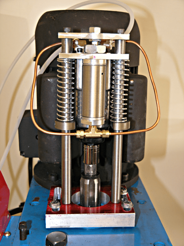

I don't know how I got by without one, now that I have it. They are available commercially for Bridgeport-style Knee Mills, but I built mine (see below). Boy, does this ever make toolchanges fast! Press "OUT" and the tool pops out into your right hand in about 3 seconds. Insert a new tool in the spindle, press "IN", and the holder or collet is torque down and ready to go in another 3 seconds. I love it!

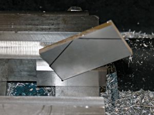

Need to cut some angles onto the valve backplate to clear the operating lever. The backplate is resting on an angle block in the chuck. I used a parallel to apply side pressure because the angle block is thicker than the piece I'm cutting.
Metal being cut or shaped by a machine tool, with metal fragments and shavings surrounding a sharp-edged piece.
There's one of those angle plates right now. They come in a set. Very handy!

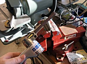

Here we are about finished. I just eyeballed it, gradually increasing depth until the point was roughly centered on the hole. Next, I take my air file to all those pointy corners.
Hand holding tool in front of red metal vise on workbench with yellow arrow and black cord.
Just got this air file on sale from Enco-it's a mini belt sander. They are awesome for this sort of thing!

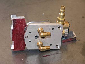

Here is the valve mounted to the valve backplate. That's my little rocker handle I milled out of aluminum. My Asian letter stamps don't stamp very clean, do they? But they'll work OK.
Machine parts including red block, metal plate, and brass fitting, likely for machining or metal fabrication instruction.
Another view of the valve backplate. This gets mounted on the mill wherever you want the power drawbar switch to be.

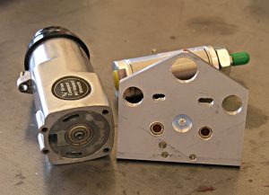

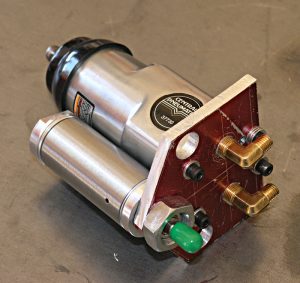

Now here is the plate that the impact wrench is mounted to.
Metal component with silver body, black cap, red base, and green knob.

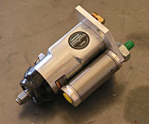

Wrench and air cylinder are mounted up!
Silver metal object with "GENERAL HYDRAULICS TYPE 50" logo.
A slightly different view...

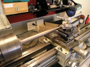

Metal lathe with cylindrical workpiece being turned, surrounded by various tools and parts in a metalworking shop setting.
Turning the rods that the impact wrench will ride on...

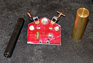

Red metal workbench clamp with black handle and unmarked brass object against dark gray background.
To make the top bracket, I used my transfer punch and brass "hammer" to center punch the holes so they'd line up. Transfer punches are handy!
Next comes the fiddly part. You've made the guide rods to proper length, and made all the brackets. Bolt the whole thing together and play with it. When you press down does the wrench assembly slide smoothly? When you release it, is the return spring pressure strong enough to return it to top? Some fiddling with the slide rods helps tremendously. In the end, I didn't have quite enough spring pressure to reliably return the wrench to the top of travel every time. The answer was to drop a couple compression springs onto the guide rods to assist. These were readily available from the hardware store.
Notes to self: Were I to redesign this thing to improve upon it, I think I'd build the springs in from the get-go. I'd also be tempted to find a way to machine some UHMW plastic to serve as the bearing material that slides on the steel rods.
The other thing that was a bit of a nuisance is the top of the IH Mill has a complicated series of concentric round protrusions that have to be cleared before the base will bolt down against the mill head. I wound up simply making my base with slots and having it sit atop the round boss. One could spend a bit more time and make the base so it sits down onto the flat part of the mill top if you wanted.

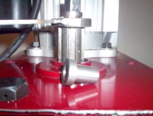

Tapered Drawbar Bushing
I came across this idea over on the HSM Board, and I think its great. This fellow replaced his drawbar washer with a tapered spacer that does a better job of keeping the drawbar centered:
Red metal part with silver drawbar spacer.
Someone else gave me this idea, here is their version...
Every now and then my drawbar gets cocked a bit and the powered drawbar has to work to engage the socket to it. It manages, but a bushing like this would make things run more smoothly.
Update 1/26/07: I made my own spacer. It took all of a half hour. Boy, what a difference! I made mine to fit fairly snugly in the spindle and leave a nice easy fit for the drawbar to go in and out. The drawbar is now very closely centered every time, the spindle seems to run more smoothly (better balanced or just my imagination, who knows?) and it was well worth doing. I am updating the drawbar page to reflect that this is a "must have" part of the project. I think it will reduce wear on the drawbar nut since the socket will be closer to right on.

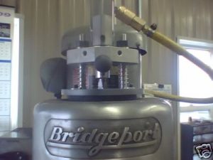

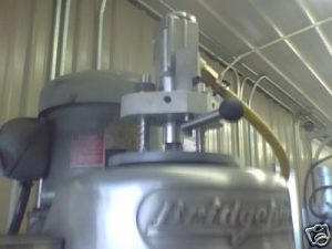

I saw this on eBay recently:
Industrial air drawbar with Bridgeport logo.
It's a little simpler design. Looks like you are meant to move the power drawbar down by hand instead of with an air cylinder and rotate the handle to control the wrench. $195 from eBay seller mad_season74.

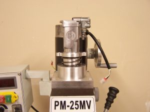

2nd Generation Powered Drawbar
The first version I built works great, and is easy to build. This second generation (which I haven't built) is just some thinking about alternate designs. I've got 2 mills and will eventually build a power drawbar for the 2nd (CNC'd) mill that is integrated with the belt drive components.
Meanwhile, food for thought:

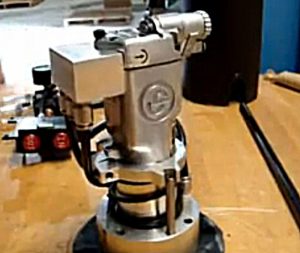

Guts of a Kurt power drawbar are built on a Chicago Pneumatic butterfly impact wrench. The air cylinder is machined into the base...Silver machine part with cylindrical base and square top on wooden surface.
Note how the butterfly impact wrench is clamped. Looks like the air block is attached via the swivel for the old wrench activating lever...
