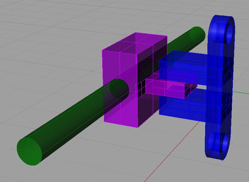

Now picture a little gate that interrupts the beam inside the optical switch. Something like this:
3D CAD mechanical assembly with green gate switch arm and purple and blue limit stops in perspective view.
Optical Switch (Blue), Sliding Gate (Purple), Arm (Green)...

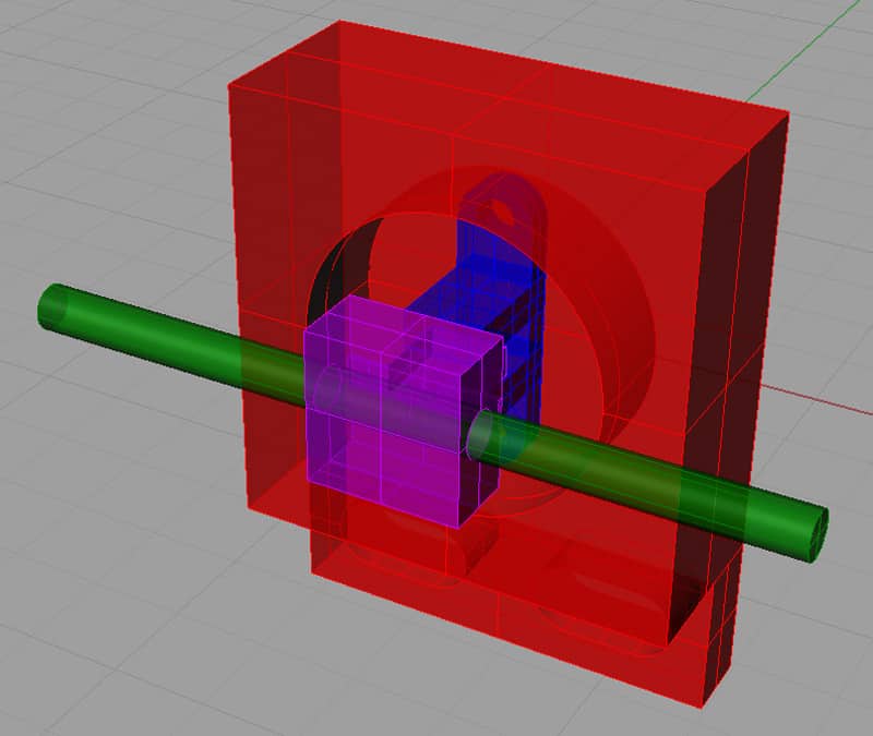

The arm has a spring on either side to center it and goes through a hole on either side of the lid:
Red, purple, and green cube on gray background.
The assembled limit switch. Note plungers on either side-it works 2 ways...
The switch is mounted rigidly via the holes at the bottom. A bracket is placed on the moving part of the machine that will press against the plunger, open the gate, and enable the beam when the limit is hit:

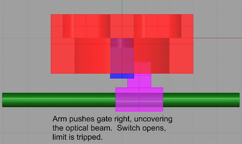

Optical limit switch with open gate and red beam in a CNC machine diagram.
The limit is tripped when the gate uncovers the optical beam...

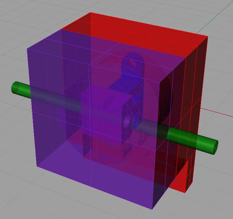

Red box with hole, green rod, and purple cubes in gray background.
With the lid removed. Do I want to make the base taller and go with a thin lid? I chose this design because my switch (the blue thing) stands up pretty tall and I was looking to machine the top and bottom out of something readily available and easily machined-in this case 5/8" aluminum.

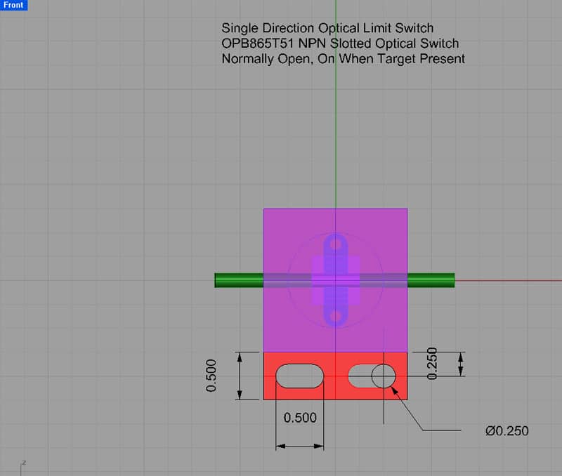

Dimensioned Drawings

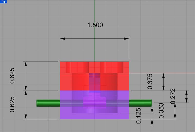

Technical drawing of a rectangular object with green rod extension, featuring various measurements in inches.
Top View...
Optical limit switch technical drawing with dimensions and design.
Front View...

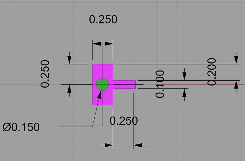

Technical illustration of a limit gate with dimensional measurements in millimeters.
Gate Detail, Top View...

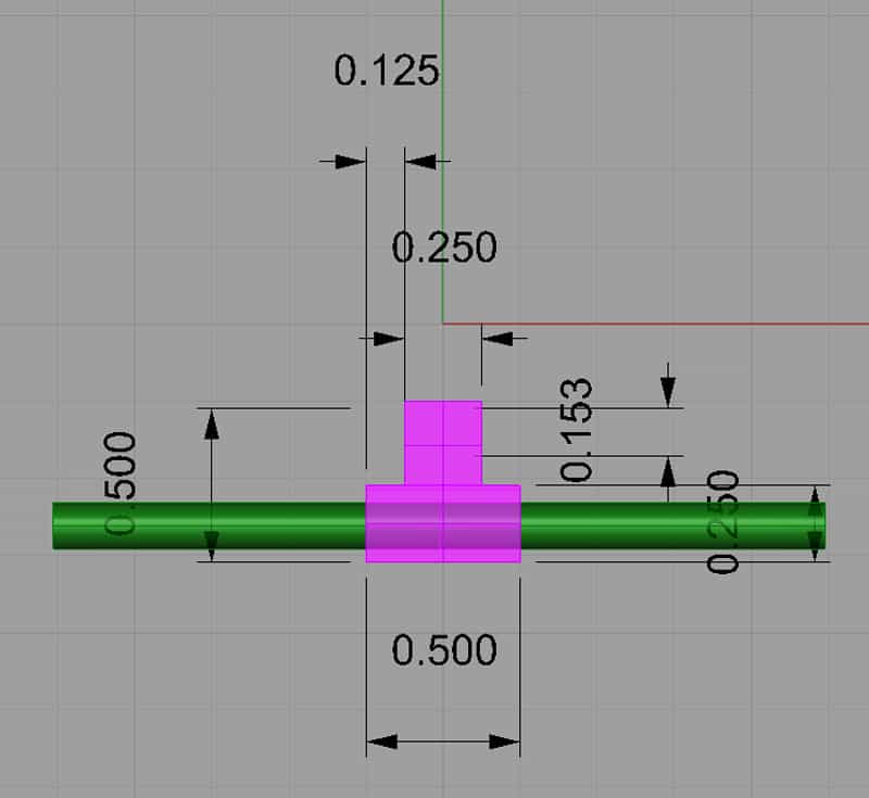

Technical drawing of a limit gate with dimensions on a gray background.
Gate Detail, Right View...
