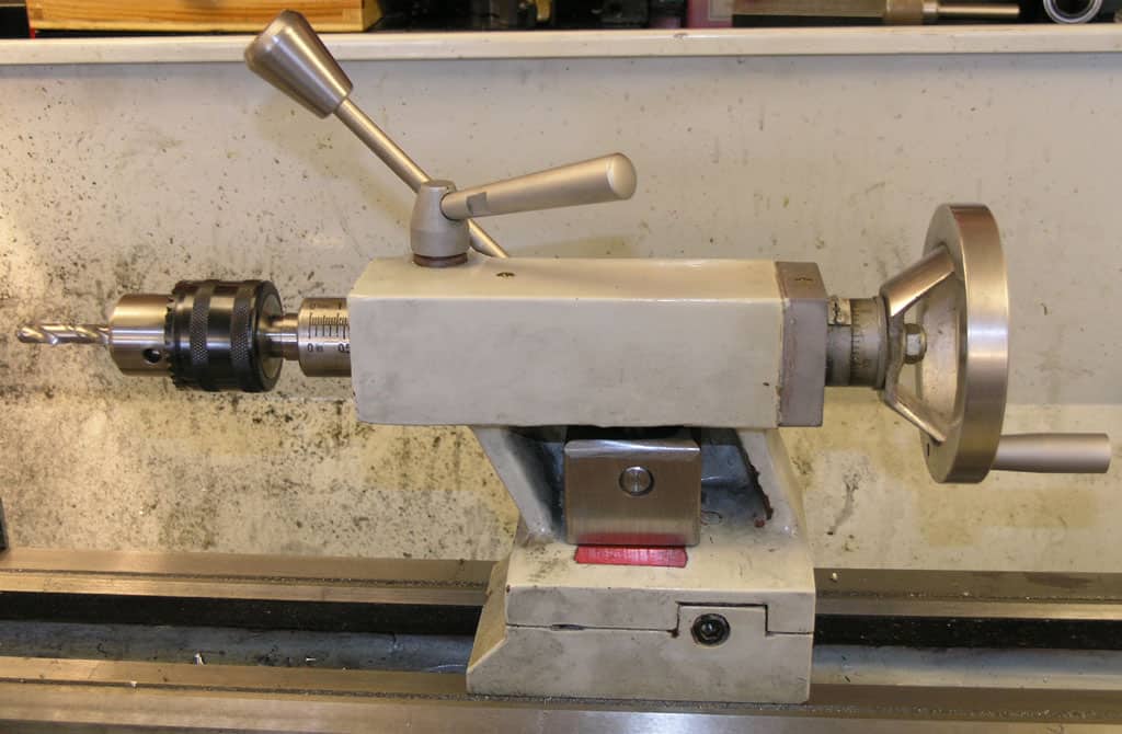

Installed on the Tailstock. No more wrench!

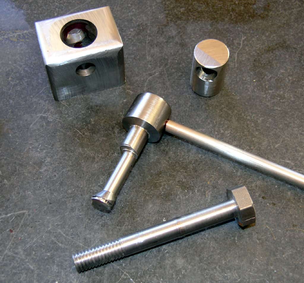

The parts: frame block, locking piston, camshaft with lever, and locking bolt...

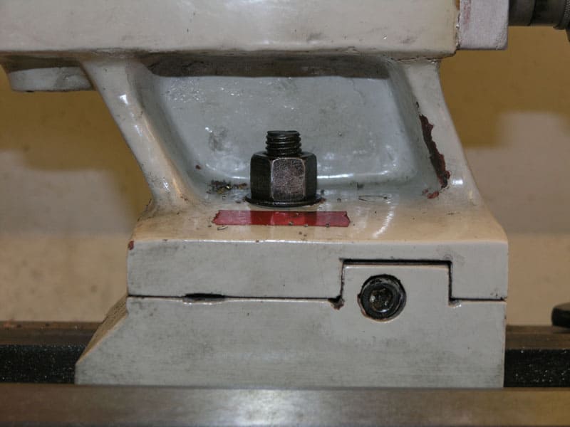

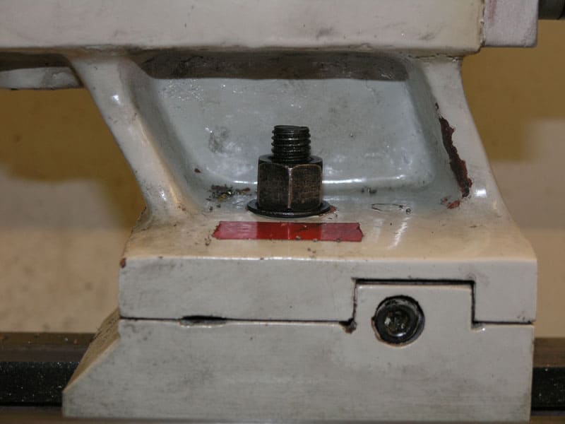

Checking how much locking motion the cam must provide
I started out looking at how the existing lock works. I determined by measuring a couple of photos that the action of the nut moves the locking bolt something on the order of 0.15":
Metalworking machine base with black bolt and red label on light gray metal.
Bolt with tailstock unlocked...
Metal machine part with central bolt on neutral background.
Locked tailstock. The motion required is about 0.150". I'll try to allow for as much as 0.200" travel...

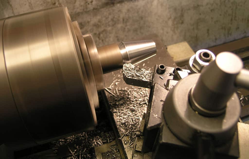

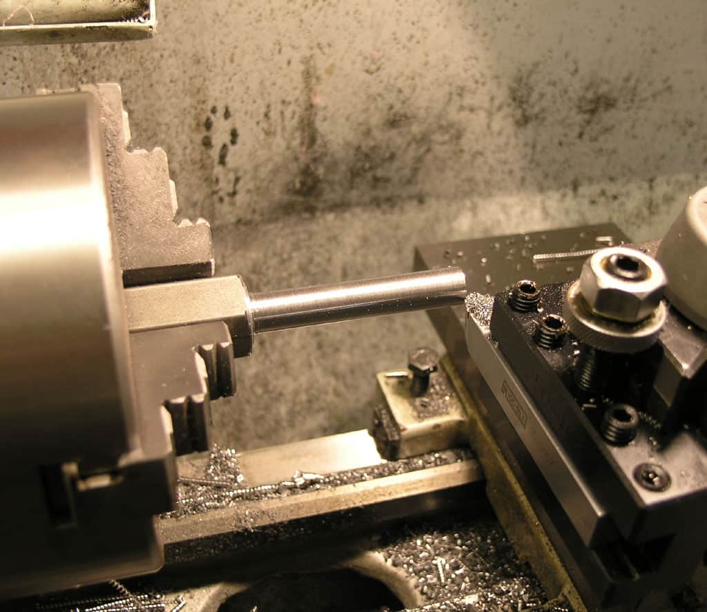

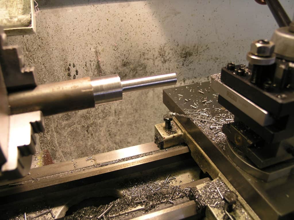

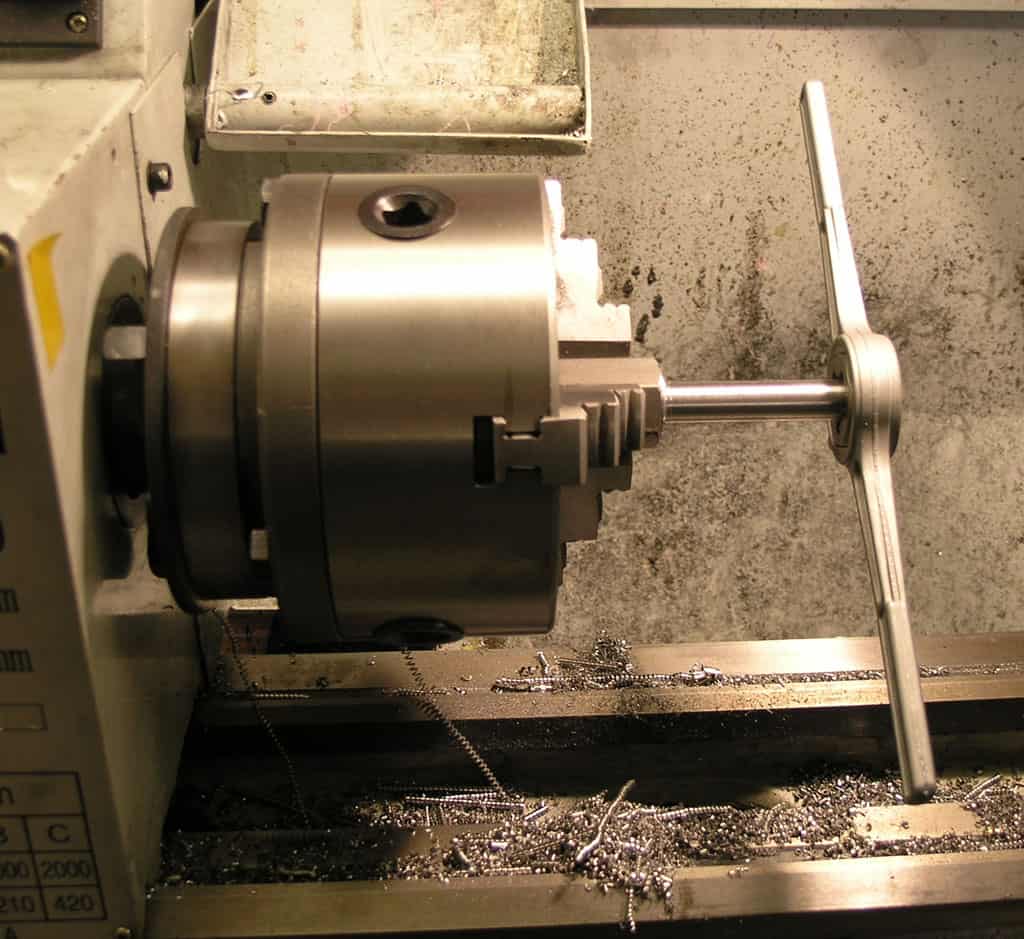

I decided to make the camshaft 1/2" diameter, with an arbitrary larger diameter that will be used to mount the operating lever. This is an easy turning job...
Metal rod being machined on a lathe in a well-lit workshop.

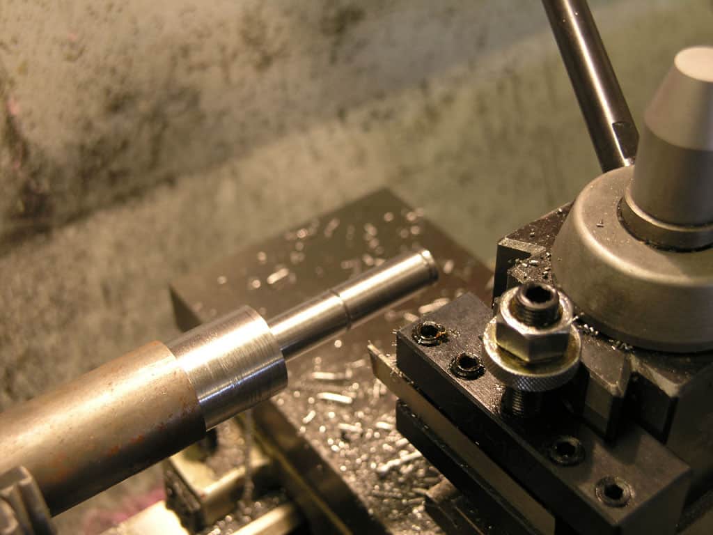

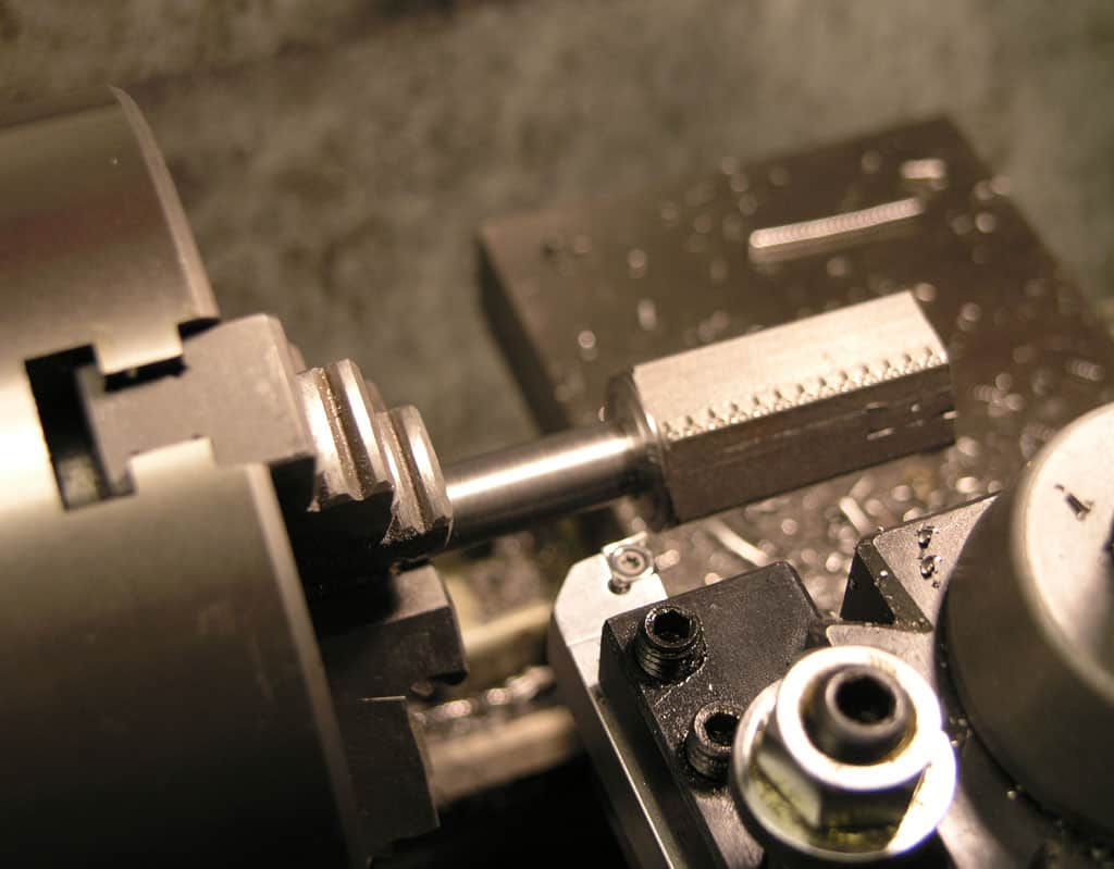

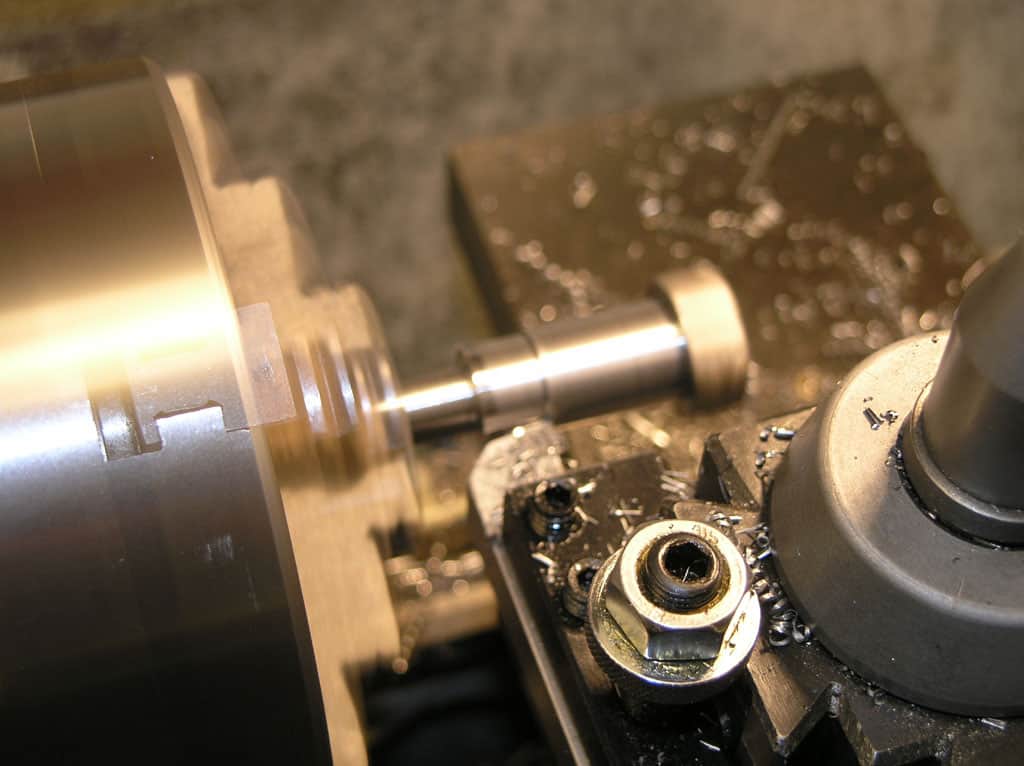

Next, I used my parting blade to put in a couple of grooves for snap rings to go on either side of a frame block. I doubt I'll use the inner ring, but the outer ring will hold the operating lever in place so it can't be pulled out.

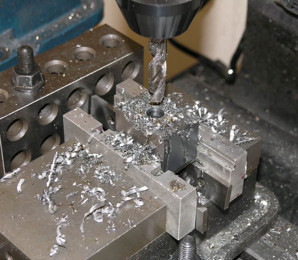

I drilled a 1/2" pilot at that point on the milling machine...
A drill press with a drill bit, surrounded by metal shavings and workshop tools.

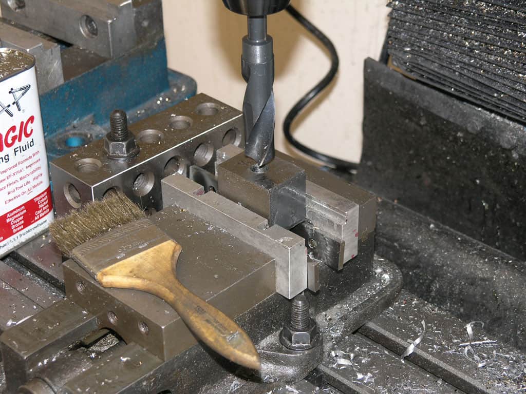

Then I bumped up to a 7/8" Silver & Deming bit. This is the largest size I thought I could drill for the cam piston bore and still leave enough meat on the frame block to act as a proper pivotig hub for the camshaft...

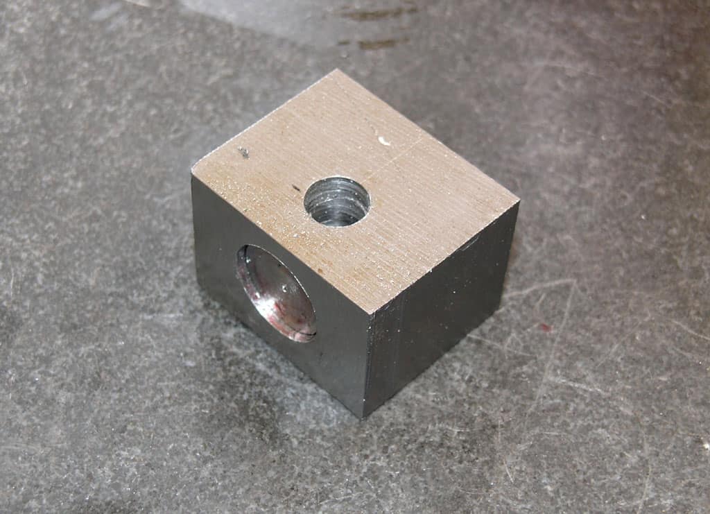

Having completed the piston bore, I used the height gage to mark out the centerline of the piston bore so I could center the cross hole for the camshaft properly on the piston bore...

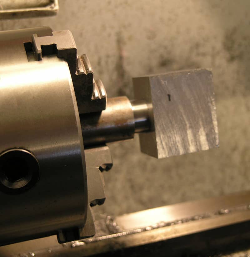

Making the locking piston
Close-up view of a lathe's tailstock with metal part bearing the numeral "1".

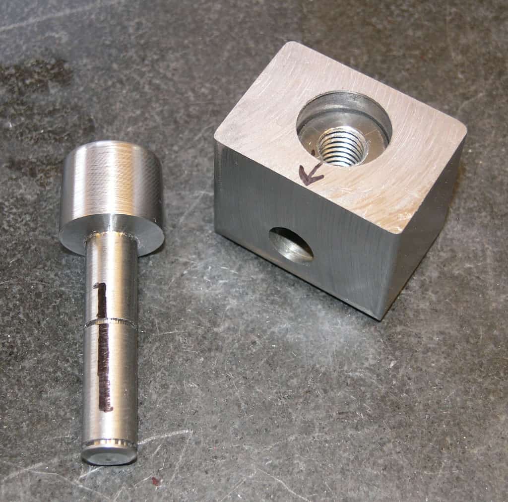

The locking piston is just a cylinder turned to fit the 7/8" bore of the frame block. Here I am testing the fit. I have not yet drilled that camshaft cross bore.

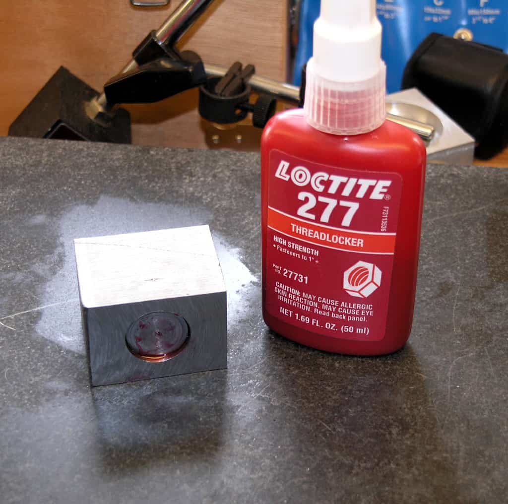

A red bottle of Loctite 277 threadlocker with orange label on a workbench among various tools.
The reason being I wanted to Loctite the piston into the frame block and drill the camshaft crossbore through both as a unit, ensuring a good fit. Loctite will release with temperature, so I will be able to get these two apart again...
Small metal block with hole and circular cutouts, machined steel or aluminum construction.
Got a 1/2" cross bore through the frame block and the actuating piston. Now a little butane torch warm up and a rap with a brass punch and hammer and I'll have these two back apart easily...

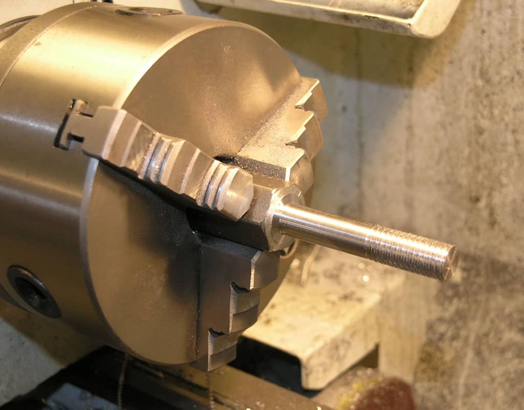

I started out with some hex 12L14 stock which I turned down to the 0.4500" diameter needed for this thread...
Metal lathe or turning center with workpiece on live spindle and surrounding tools and materials.
I then threaded it with a die...
Metalworking lathe chuck with radial jaws and threaded rod.
Looks clean. Next step is to flip this piece around and finish the other end...

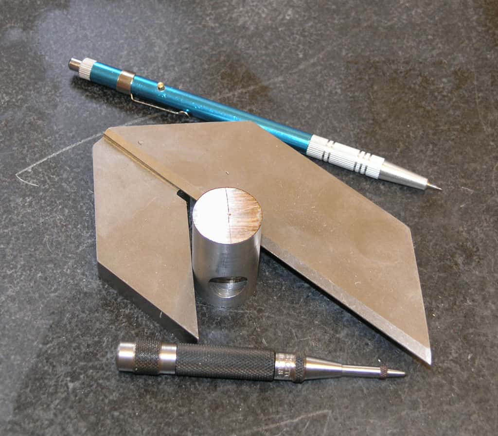

That big crazy shaped gadget is for marking the center on round stock. I used the carbide scribe to mark two radials and then my Starrett automatic punch for the center. After that I drilled the requisite hole for a 1/2"-13 thread and used a tap to thread the piston...

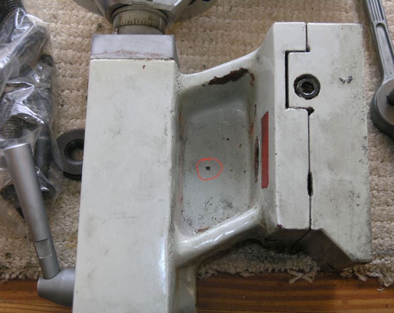

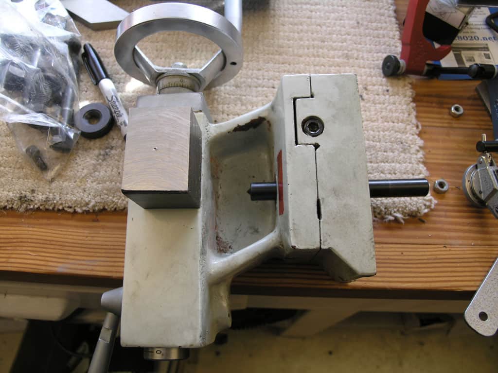

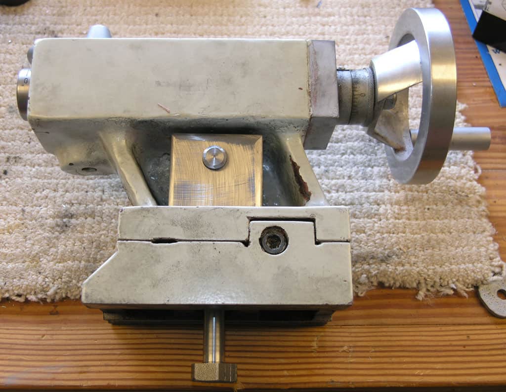

Drilling the Tailstock to Mount the Camlok
At one point it would have made me squeamish to drill a hole in one of my machines, but no longer:
Metalworking tool on carpeted surface with rectangular base and vertical posts.

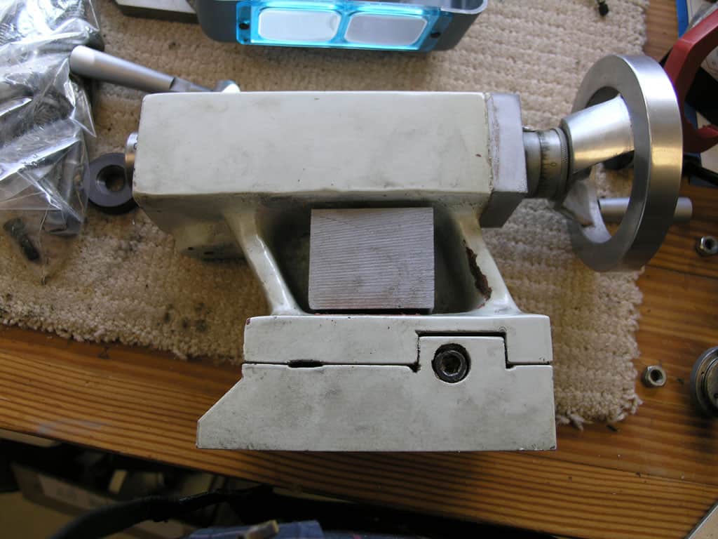

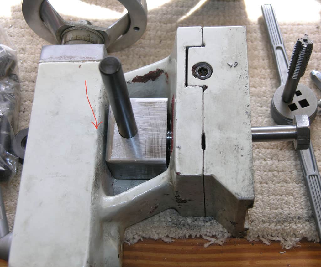

Using my 1/2" transfer punch and locating the piston with the bolt, I mark where to drill. Since I only have two hands and I'm taking a picture, I can't hold the piston and block in their proper position flush against the bottom of the tailstock, but rest assured I marked the hole in the right place!
Worn white metal object with red highlighted central hole.
It goes right about there. I can't believe I forgot to take pix of the process, but I did. Got to excited I guess! Basically, I clamped the tailstock on the mill. I supported the ram housing on a 1-2-3 block and then used varying sizes of parallels under the base until I had it oriented so the hole would be perpendicular to the ways. The cast iron the tailstock is made of cuts very nicely. No real drama there.
Metal vise on a wooden workbench.
And here is a trial fit up. We are on the right track!

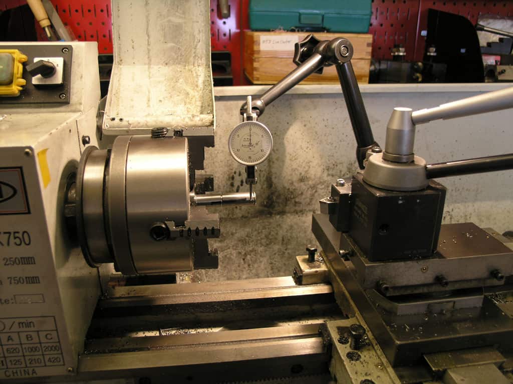

Next I dialed in the camshaft on my 4-jaw. Then I used the dials to move my indicator out to an 0.2" greater diameter. I wanted to have 0.2" of travel when the cam operated. Lastly, I used the 4-jaw chuck jaws to move the workpiece until it just registered again on the DTI. Now the piece is offset 0.200" in the 4-jaw and if I turn it, I'll be cutting an eccentric...

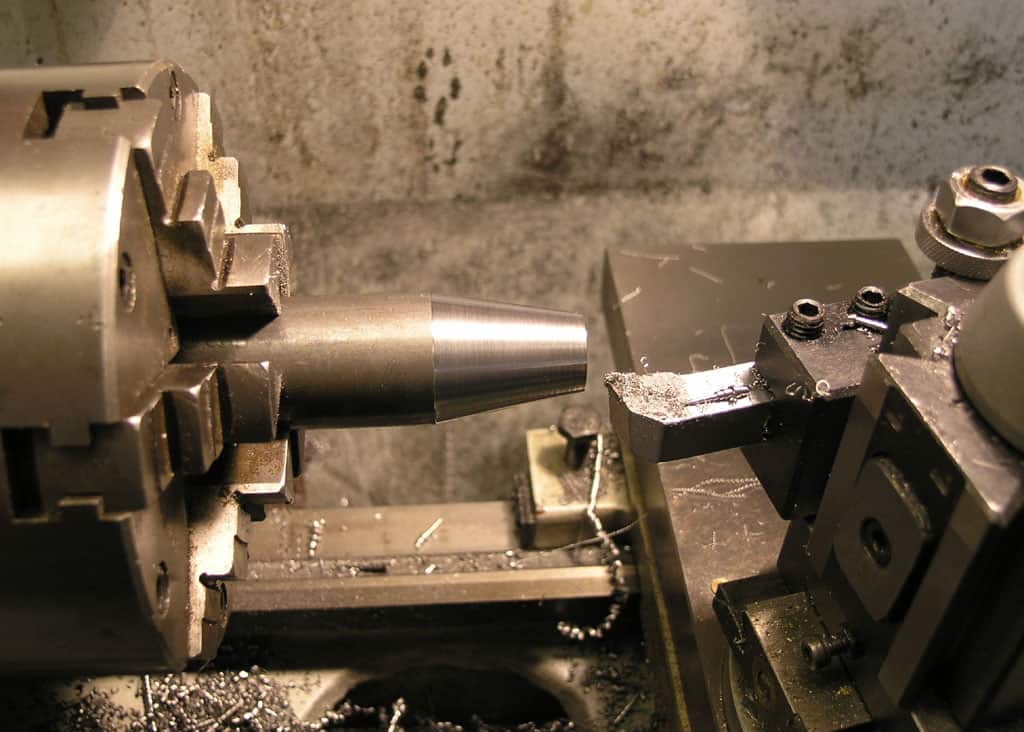

Now the top angle gives us a little gearshift knob shape...
All Done, Let's Try It Out!
Metal parts, including bolts and nuts, on a dark surface.
There's the eccentric as well as the rest of the components of the project. I "glued" the lever into the camshaft using Loctite. I chose the angle for the hole by eyeballing where I wanted the lever to be when the cam was in the "locked" position.
A drill press with a metal body and adjustable handle mounted on a stand, featuring a securely fastened chuck.
There it is in action! It works amazingly well with very tight clamping action with the lever to the left, and complete freedom to slide the tailstock with the lever to the right. You'll need to adjust it by tightening the bolt as tight as it can be with the level in the unlocked position and still be able to slide the tailstock.
