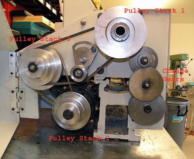

Let's begin by reviewing the lathe's normal gear layout:
Pulley Stack 1: This stack drives the spindle
Pulley Stack 2: This stack is on the motor
Pulley Stack 3: These are the "Low Gears"
Change Gears: For cutting threads

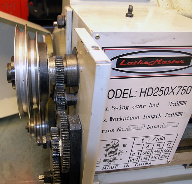

The range of speeds available by default is:
- Stack 2 (Direct from Motor): 620, 1000, 2000 rpm
- Stack 3 (From "Low Gears"): 125, 210, 420 rpm
The low gears are provided by the toothed timing belt that seems to have a range of about 4.76:1.
We can see the different pulleys in the stacks in this photograph:
Speeds on pulleys are low, medium, and high, left to right
The multiplication range of these pulleys is 0.62:1, 1:1, and 2:1. Based on all of these ratios, when we take the middle pulley and the 2 (motor) stack, we can see the motor nominally runs at 1000 rpm.

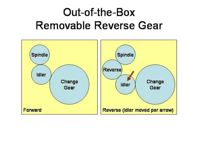

Okay, now let's look at how we reverse the leadscrew in the normal factory-approved manner. Consider the following diagram:
Factory-approved Reversing Mechanism
The factory would have use remove the Idler gear to a new location below and slightly to the left (direction of red arrow), and install a reversing gear next to it whenever we want to reverse. It makes it possible to reverse, but it sure ain't easy! Note that the gear on the spindle, the Reversing Gear, and the Idler Gear are all the same size, about 42mm in diameter. This is to ensure that the gear train runs at the same speed regardless of which direction we're running it in.
Below, we'll take a look at possible ways of adding a tumbler reverse to this geartrain.

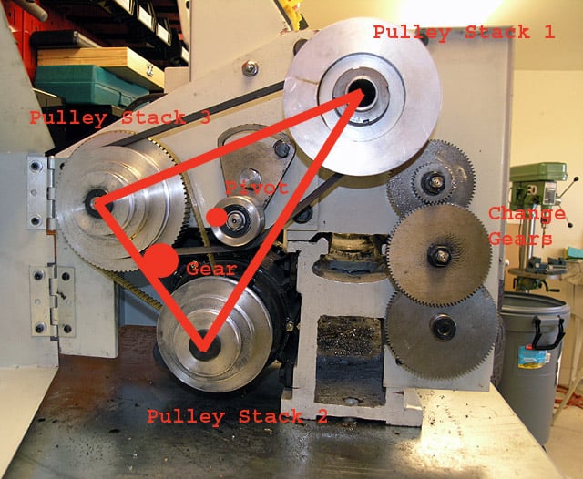

I'm envisioning two tumbler mechanisms. The first would be a fairly standard tumbler reverse, done just as one commonly sees it on any 9×20 lathe. The second would tumble between taking power from Stack 2 (the direct drive motor stack) and Stack 3 (the low gear stack). Our new Variable Speed DC Motor has a maximum speed of 4500 rpm. Using the aforementioned tumbler mechanism with the same ratios already on the lathe, and the assumption we will turn our motor no more slowly than 120 rpm, we should be able to deliver the following speed ranges:
- High Gear (Direct Motor Drive, Stack 2): 120 - 4000 rpm
- Low Gear (Off Stack 3): 25 - 840 rpm
I'm assuming the extra tumbler gears and pulleys will be a straight 1:1 ratio to the spindle. The modification would involve removing the pulley stacks from the motor and "low gear" area, leaving the timing belt intact, and replacing said stacks with gears that interact with 2 gears on the tumbler plate. Because we use 2 gears, we keep the same direction of rotation. One gear tumbles between the 2 stack spindles, and the other sits at the pivot with a single pulley on it taking belt motion back to the lathe spindle. I'm guessing I can cannibalize the middle (direct drive) pulley from one of the two stacks and drive the lathe spindle belt with that.
This represents quite an improvement over the stock lathe speed ranges. We have extended the high end by 2000 rpm and lowered the bottom end from 125 to just 25 rpm. Any slower and we would do just as well to hand crank the spindle (the subject for another modification I'm sure!). Here is what the geometry for the Hi-Low Tumbler might look like:
Hi-Low Tumbler Geometry
The Hi-Low Tumbler Geometry is the classic triangular planform. A gear takes power off either Stack 2 (Direct Motor Drive) or Stack 3 (Low Gears). It is pivoted in the vicinity of the current idler mechanism. I am envisioning this gear turning a second gear at the pivot that has a pulley on it that will mesh perfectly with the middle (direct drive) pulley on the spindle. Since it is located at the pivot point, belt tension remains a constant. We'll need to create a mechanism for releasing the tension so the belt can be changed. This could be achieved with an arrangement similar to the current idler, which would likely have to be relocated. A Hi-Low shift lever would extend straight upward from the pivot. Push the lever forward to get "Hi Gear" and pull back for "Low Gear". Sounds intuitive enough, eh?

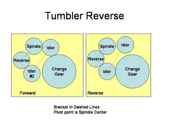

Now let's look at the potential for a Tumbler Reverse mechanism. Having seen from the diagram above how things work, Lathemaster provides with a harder challenge than the normal 9×20 lathes in fabricating such a mechanism. Typically, we can pivot around an idler gear and bring our tumbler into play. In this case, the threading gear train has no such idler gear, as all the gears are in a vertical row. Instead, we may be able to pivot around the spindle, as follows:
Pivoting a Tumbler Reverse Around the Spindle
We could probably also have pivoted around the Change Gear, but is is moveable, and so that would not be a satisfactory solution. In fact, we can pivot at any point along a line drawn so that it intersects Spindle and Change Gear centers as long as we're far enough from the gap between the two gears to provide a gentle enough engaging arc. We could also design this system as a sliding "linear" engagement where the two gear sets move on a line instead of a pivoting arc, so we should think about what makes the most sense. It might also work to pivot on that line slightly above and to left of the spindle too, and use a fork-shaped plate that goes around the spindle and holds our gears.
As for the gears, what's needed is to introduce 2 new gears. In the "Forward" mode, we essentially swap our original Idler from below the line between Spindle and Change Gear to above, in mirror fashion. In "Reverse", we swing the "Forward" Idler up out of the way and bring the normal Factory Reversed Idler geometry up from below. Tricky, eh? In order to accomplish this magic, we shall need to order a spare "Reverse" Idler from Lathemaster, fabricate a plate to mount all these gears to, and make sure we can attach that plate so that it pivots around the spindle. No mean feat!
