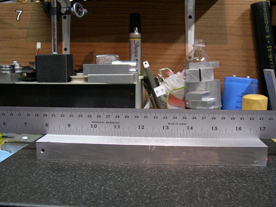

Here's what you need: a screen for projection, a place to put the object you're measuring, and a laser level. We'll start by measuring the flatness of a surface plate. Set up the laser level to project a line onto the object. You should be able to adjust the laser's angle, height, and parallelism to the surface. If the line isn't parallel to the surface, the result will look like this:
Laser line not parallel to the surface...
When properly aligned, it should look like this:
Proper parallelism achieved...
The other adjustment besides parallelism is angle of incidence. You want the angle such that the laser sweeps the entire surface to be measured.
Salt sprinkled on the table will show whether the whole surface is illuminated...
The bottom line is projected directly on the screen and represents a reference as it is a portion of the top edge of the projected light from the laser that overshoots the test object. The top line on the screen is the portion that is reflected from the test surface. Because of the extremely low angle of incidence the entire test surface is illuminated and the entire surface contributes to the reflected image that composes the top line. This is obtained by careful adjustment of the height and angle of incidence of the laser.
The angle of incidence is adjusted so that the beam sweeps the entire surface of the test object. When it is correct the separation between the top and the bottom lines on the screen will be about equal to the thickness of the original laser line multiplied by the ratio of the distance of the laser to the center of the object and the distance from there to the screen. In this setup it is about 5 to 1.
Because of this a multiplication of any errors of slope is obtained. In this setup it amounts to about 240 times. This is arrived at from the ratio of the width of the laser line, about .1 inch, compared to the length of the area it illuminates, about 12 inches. This gives a factor of about 120 but is doubled because the angle of reflection is opposite and equal to the angle of incidence. That gives 240. The amount of multiplication will vary depending on the angle of incidence. If the angle of incidence is kept the same for other test objects the multiplication will remain the same. The lower the angle of incidence the greater the multiplication. The angle of incidence must of course be greater than zero.
The amount of error in slope on a surface depends on what distance that error covers. A concavity of .001" over ten inches produces much less error in slope (about 1/10) than the same .001" over a distance of one inch.
