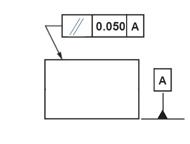

Parallelism Callout on Drawings
Parallelism callout symbol with 0.050 tolerance and reference letter A.
Surface Parallelism Callout...
The Surface Parallelism Callout above shows how Surface Parallelism can be called out on a drawing. Parallelism is relative to the "A" datum in the callout.  The feature control frame specifies the tolerance and which datum is the parallelism control.
