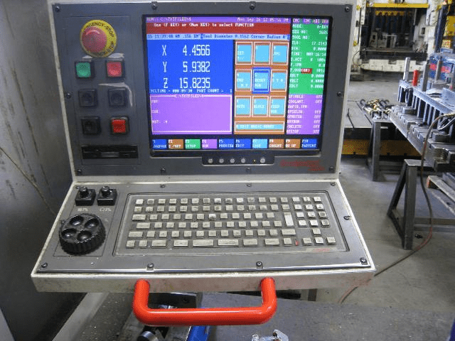

Notes on the Bridgeport DX-32 Post
A computer screen showing a CNC machine control panel with buttons, knobs, and keyboard.
People tell me they love their Bridgeport DX32 controls.  There’s a small but vocal minority of folks still using them, and the DX32 topped the list of requested Post upgrades on our recent G-Wizard G-Code Editor Survey.  So, I rolled up my sleeves  and over the last 2 releases of G-Wizard Editor, I added a bunch of things to the post that deal with the unique g-code dialect of the DX32.  In case you thought g-code is just g-code, here are some of the “big ticket” items I tackled:
Triple Z’s
The DX32 uses what I call “Triple Z’s” on the drilling cycles.  In other words, there are three Z-words in the block that specify:
–  Hole depth
–  First peck amount
–  Remaining peck amounts
For most controls, repeating a word on a line is an error.  Not so the DX32 and its “Triple Z’s”.
Subprogram Syntax
Fanucs and many other controls use a subprogram syntax most g-code programmers are familiar with.  But the DX32 does something completely different:
“#” is used to identify subprogram numbers. So “#32” is like “O32” on most controls.
“=#” calls the subprogram. “#=32” is the same as “M98 P32”.
“$” signifies return from the subprogram just as “M99” does on Fanucs.
I’m sure there’ll be more things from my DX32 users, but this moves the ball considerably closer.
