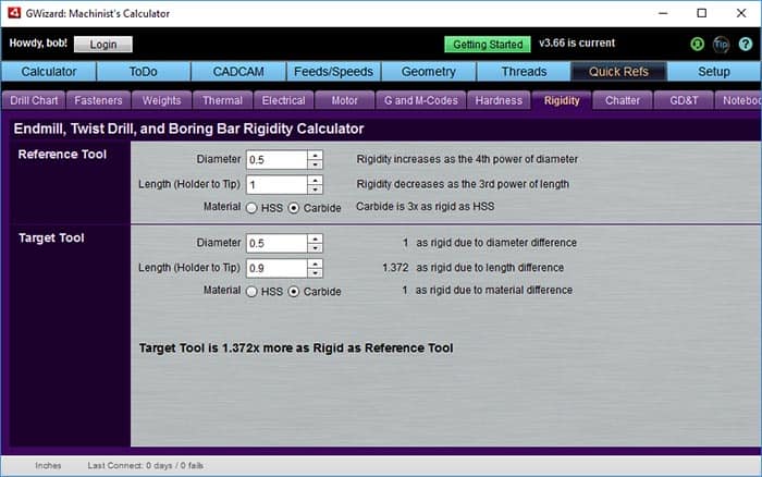

As you recall, we're stuck increasing MRR's because we're hard up against Tool Deflection limits. The deflection is proportional to the Rigidity which resists cutting forces which are proportional to Material Removal Rates.
Therefore, if we want to increase Material Removal Rates, we much first increase Rigidity. G-Wizard's Rigidity Calculator can be found under the Quick Refs tab, and it is a quick way to play with some ideas.
Rigidity Calculator screenshot from CNCCookbook.com website.
Decreasing stickout from 1" to 0.9" gives us a tool that is 1.372x more rigid...
Most CNC'ers are surprised to learn just how big an impact small changes in stickout and tool diameter can make. The Rigidity Calculator makes it obvious. For example, decreasing stickout from 1" to 0.9" gives us a tool that is 1.372x more rigid.
