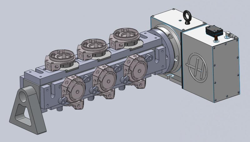

Fixture Design: What's the very first thing to do when designing a fixture?
Designing fixtures can be so complex and specialized, that there are many CNC firms totally dedicated to the job of offering Fixture Design Services.  These days, many firms are using 3D Printing to create sophisticated fixtures.
If you're like me, you're something of a fixture junkie.  Smart fixturing really can save a lot of time, and it's hard to learn to be good at fixture design.  So, as a fixture junkie, I am always on the lookout for new fixturing ideas.
But here's an important fixturing tip, perhaps the most important one you will ever see:
The first step in fixture design is to decide whether you even need a fixture at all!

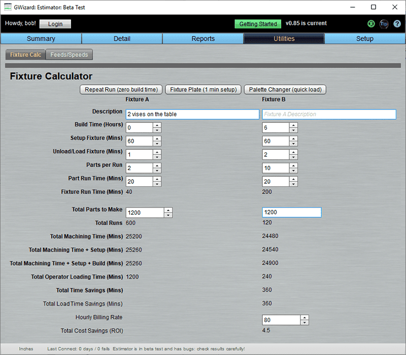

It turns out that it is tragically knowable whether spending time to create a fixture makes sense or not.  Our G-Wizard Estimator software includes a calculator that's designed to help you  decide whether a particular fixture makes sense or not.  All you have to do is answer a few question and it cranks out the answer for you.
Here's what the Fixture Calculator looks like:
A screenshot of CNCCookbook.com's fixture calculator tool with gray background, white text boxes and a progress bar.
The Fixture Calculator from G-Wizard Estimator...
The idea is to fill out some basic information on two fixturing alternatives.  In this case, we're comparing a couple of vises to a custom fixture plate with toe clamps that will hold 10 parts.  So, the vises can do 2 parts per lot and the fixture plate does 10.  Here's the basic information that has to be filled in to evaluate the fixture design:
Lastly, we need to know how many total parts are to be made.  In this case, I picked 1200 because it was the number where the two came out equal in terms of total time.
Of course there are some things to think about:
By playing with some different scenarios, you can get an idea pretty quickly of whether it will make sense on a particular job to take time out and build a fixture.
Having a good fixture calculator sets you up to start your Fixture Design efforts right.  You'll know whether investing in building and designing a custom fixture makes sense for your job.
