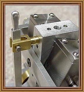

Of the Verburg engine designs available, the Reversible Vertical Twin Wobbler seems to have been very popular, as it is easily found on the net. Here are some typical photos:

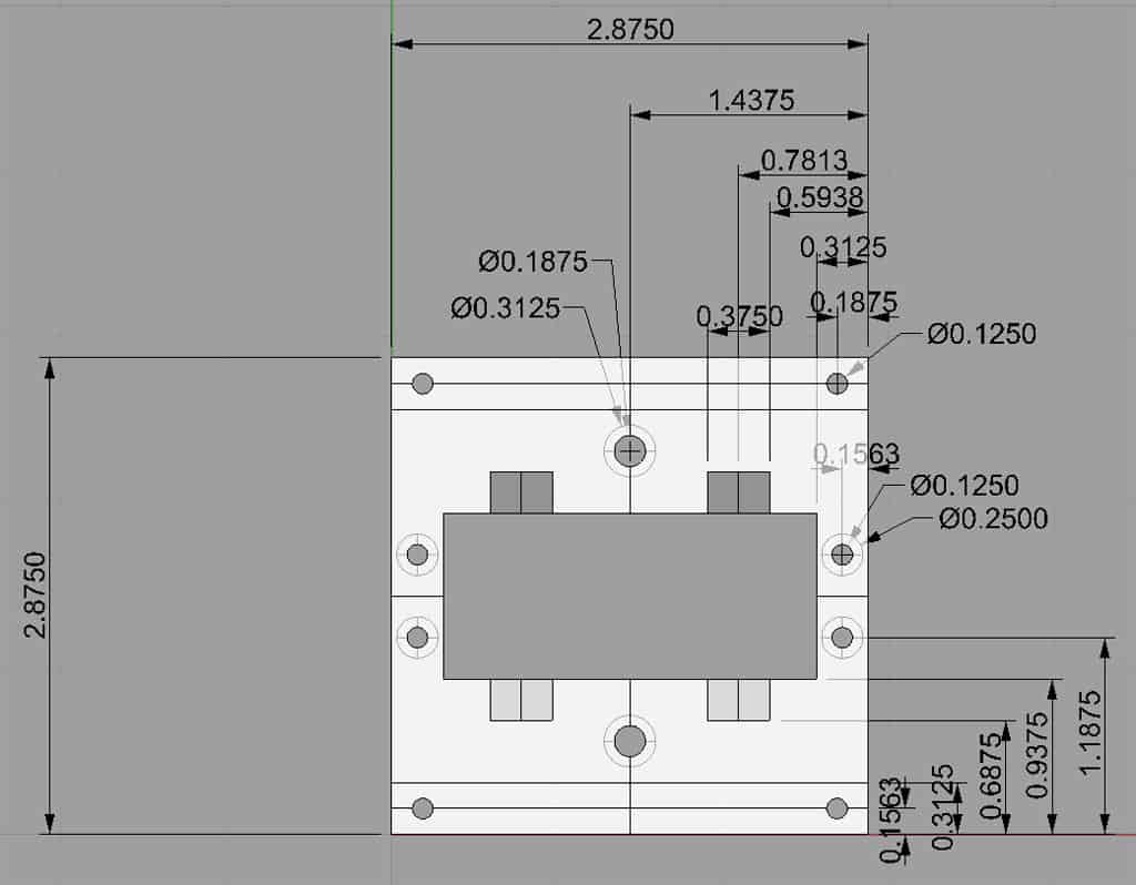

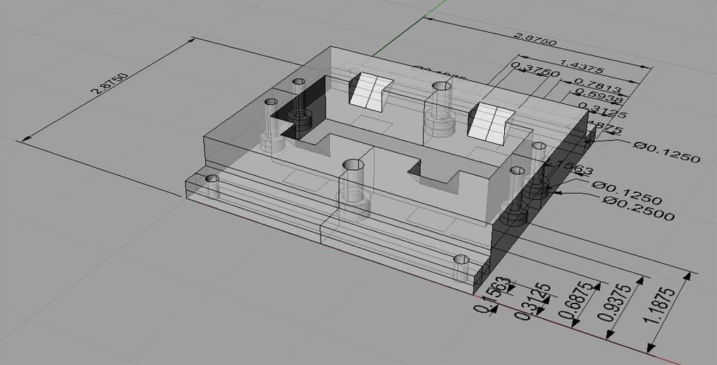

Let's start out building the base. Here is my Rhino drawing with dimensions:
Technical drawing of a machined metal part.
Top View of the Base
Technical drawing of a base plate.
Perspective View of the Base. Note: Crank clearance slots are 45 degree angles.
Cylindrical object with technical drawings and dimensions.
Front View
The base looks pretty straightforward. Need to start with some 1/2" stock, I'm using 6061 aluminum. I plan to do the center hole first, followed by the crank clearance cutouts, the I'll mill out the mounting rails, and lastly will drill the holes. All right then, let's get started!

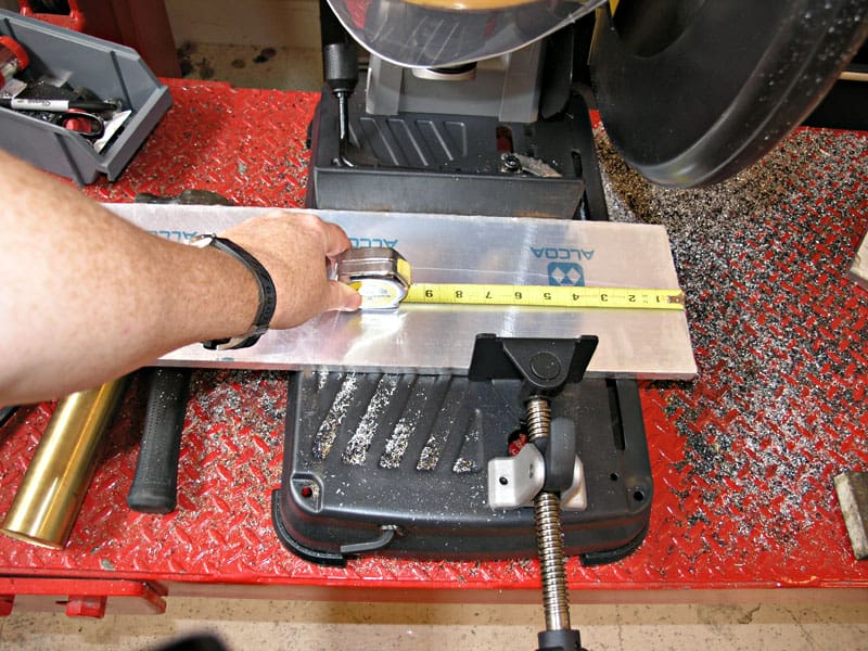

First task is to slice off some stock with my De Walt Multicutter. Need approx 3". I'll mill the other dimension. This is 1/2" thick 6061 MIC-6 aluminum, which means its ground very flat on 2 sides. Nice stuff!

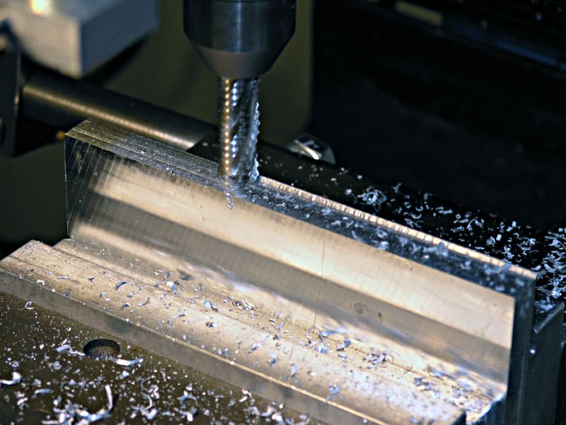

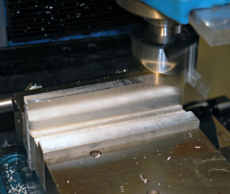

Next I am fly cutting the 2 long edges so the block will be square for layout. The ends will get cut too, but with an endmill...
Metalworking process in action, featuring machinery and manufacturing environment.
Once the long edges were square, I used a rougher to cut the edge down until I had the right 2.875" height...

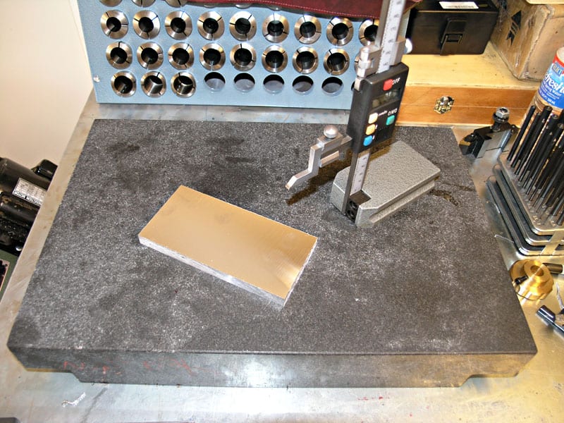

Next Stop: Surface Plate, Height Gage, and Layout. Gotta Put Dychem Machinist's Dye on First Though...

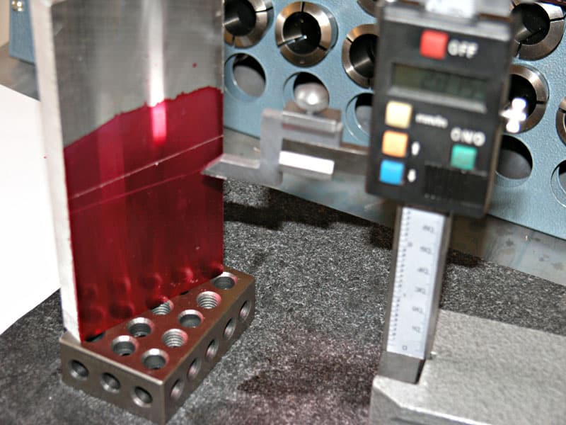

Sorry for the Blur! Why is it on a 1-2-3 block? Because the height gage doesn't measure down to zero. So, I zero it on the 1-2-3 block, then take my measurements from there. The red Dynchem helps make it easy to see scribe lines. Here I am scribing a line at 2.875", which will be the edge of the base plate.

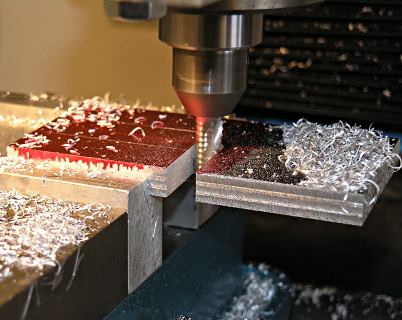

I'm just going to use the mill to cut this thing to length and square the other edge at the same time...
Metalworking machine with attached cutting tool and metal shavings.

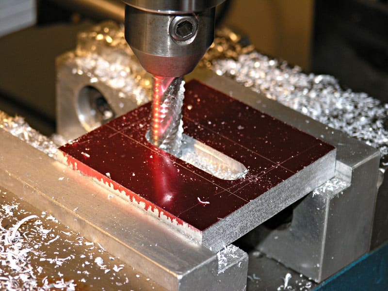

Next, I cut an initial slot in the middle. I ramped down to get there, working things back and forth on the X-Axis while steadily increasing depth of cut until I had made it all the way through the block...
Milling machine cutting tool in operation, surrounded by shavings.

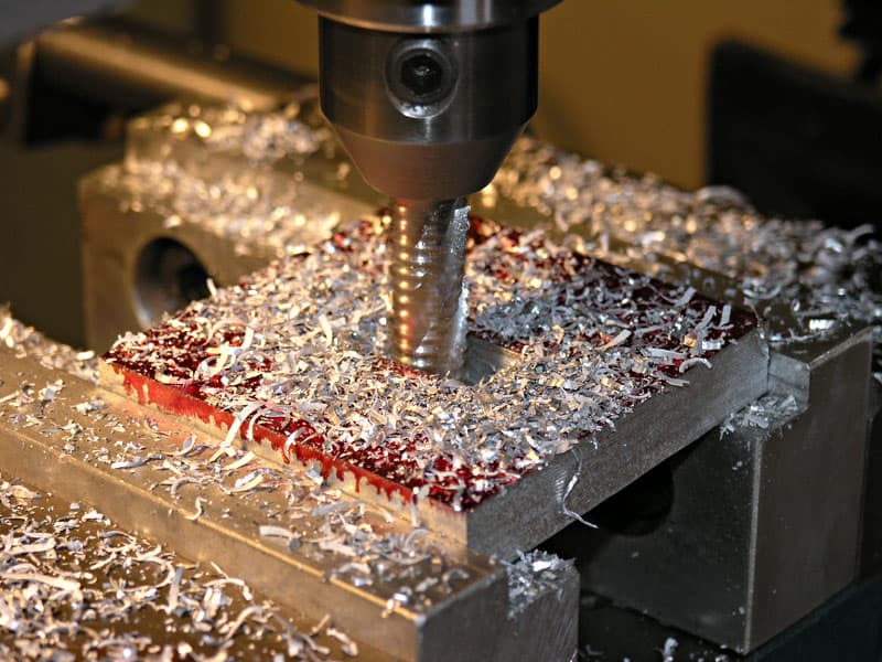

Cutter gets buried in chips! This is where some flood coolant or at least an air nozzle would be nice to keep the chips evacuated...
Metal workpiece being drilled with a drill bit.

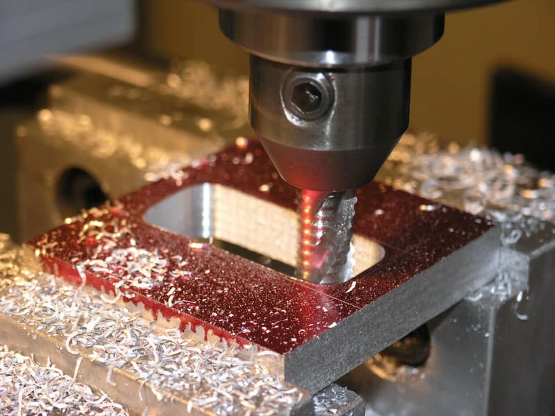

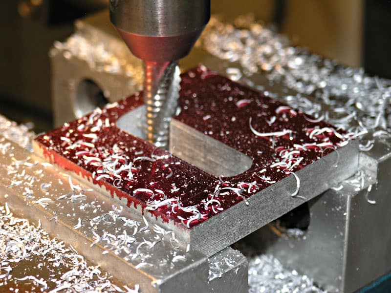

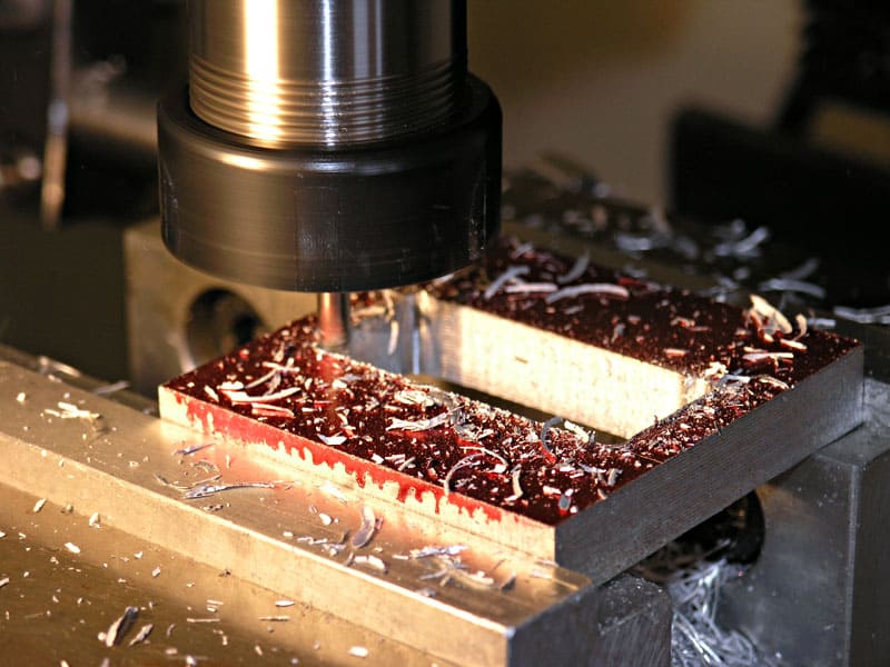

After I got to full depth, I started widening the racetrack until I had cut all the way out to the layout lines. It's hard to get the corners just right!
Metal cutting tool in action, surrounded by shavings and debris on a red square metal object.

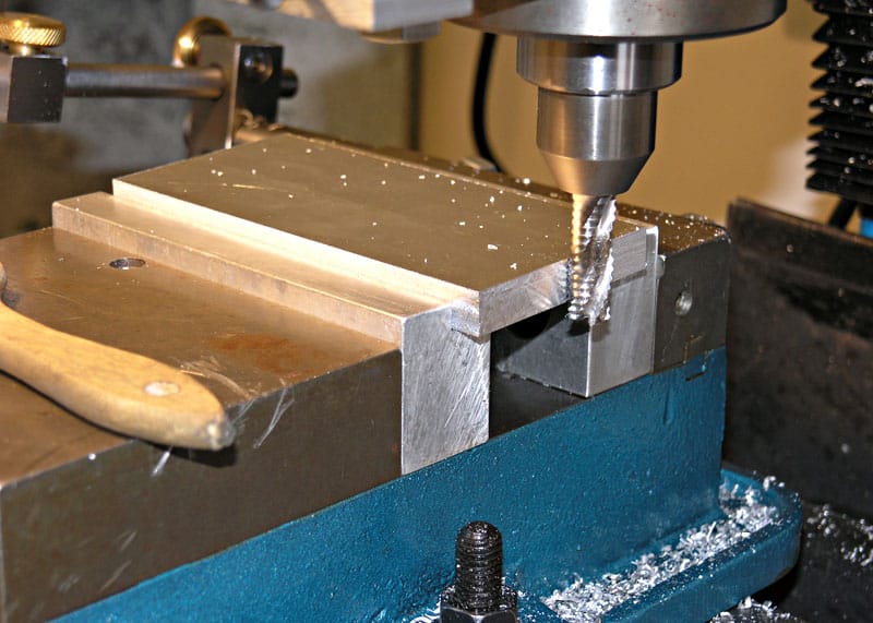

We're nearly as far as my 1/2" end mill can go...
Metalworking machine tool with cutting tool and shavings.
For the last part so I could get as far into the corners as possible, I switched to a 5mm diameter endmill I had. It was the smallest thing laying around...
Metalworking machine with drill bit in place, surrounded by metal shavings.

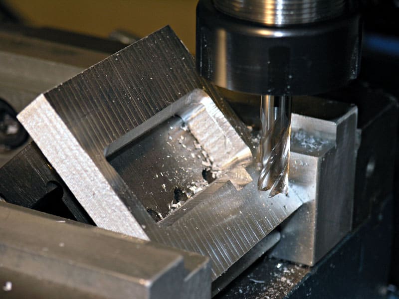

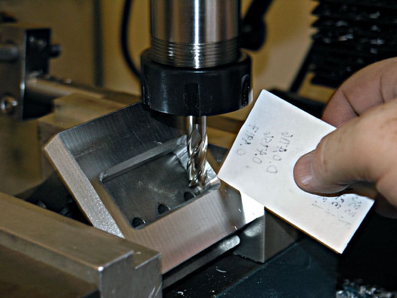

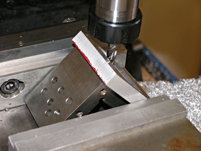

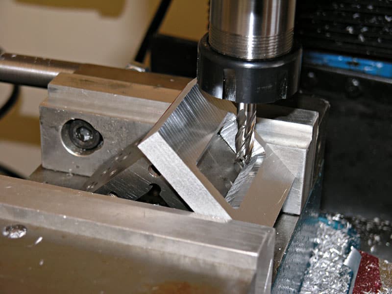

Getting ready to cut the 45 degree crank clearance pockets. Note I chamfered the edge of the hole...
Metalworking machine cutting tool close-up.
Yes Virginia, that's an angle plate sitting on its face to provide the 45 degree reference...
Person holding white card above metal drill press or milling machine in a workshop setting.
To measure, I touched off the right edge, then backed off with my handwheel graduations the appropriate amount shown on the drawings...
A milling machine in an industrial environment with a black cylindrical component on its surface featuring grooves.

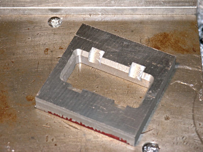

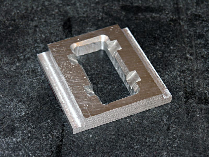

Zip, zip, zip, and we're done with this one...
A square metal object with a central rectangular recessed area, featuring a rough, unfinished aluminium-like surface.
Got dem pockets done now!

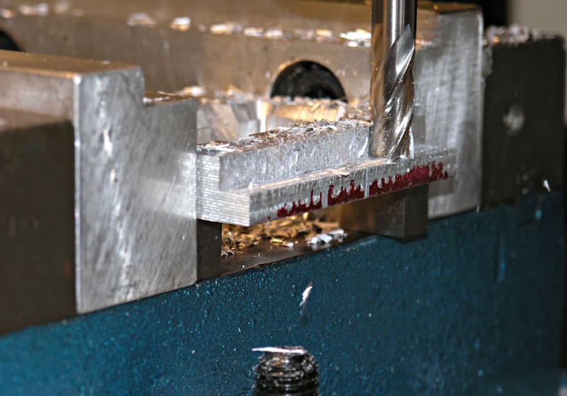

Now we cut the mounting flange. I was trying to climb mill where possible on these...
Square-shaped metal object with a central rectangular cutout.
Milling is done. Time for drilling next...

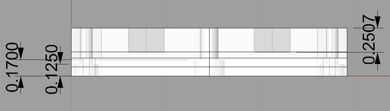

Crank Bearings

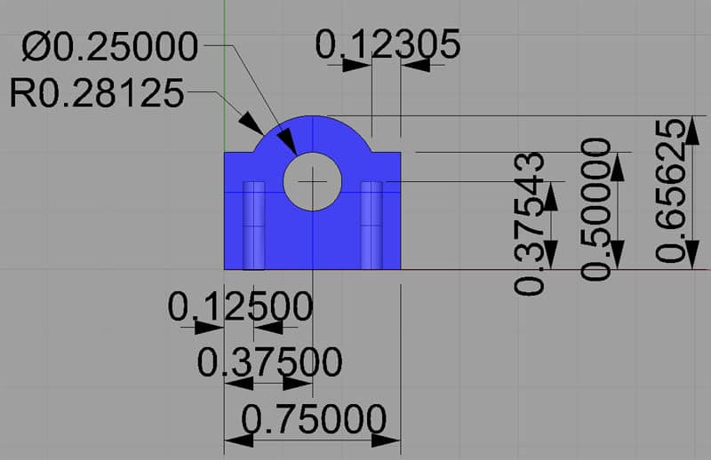

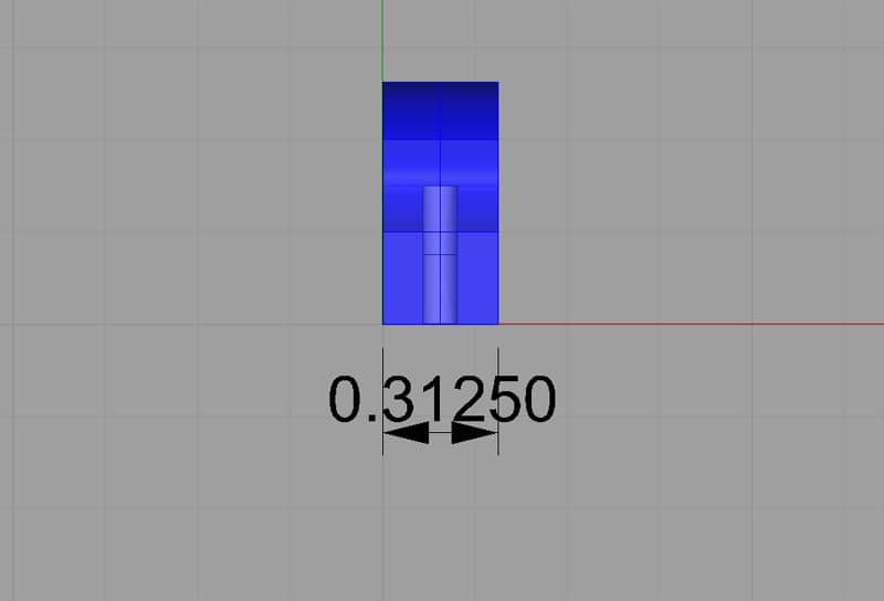

The crank bearings are made of brass, but are fairly simple in design:
Crank bearing assembly CAD drawing.

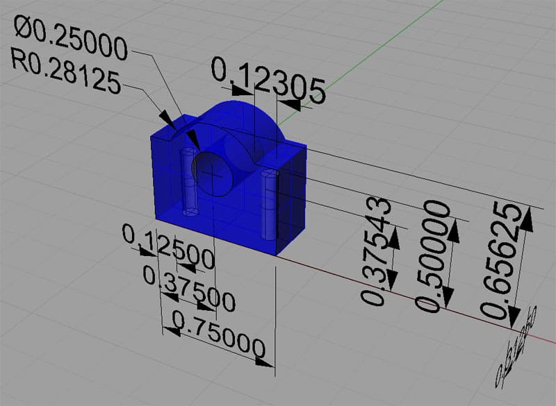

Perspective View...
Crank bearing technical drawing with detailed millimeter measurements.
Front View. The mounting holes are 4-40...
Technical illustration of a crankshaft bearing with measurements.
Right View...
Okay, we need 2 of these little guys made from brass. A piece of brass plate in the neighborhood of 3/4" square by 5/16" or 1/2" thick should do nicely as a starting point. Alternatively, some 1" diameter round stock may also be used if you don't have any brass plate on hand (I didn't).

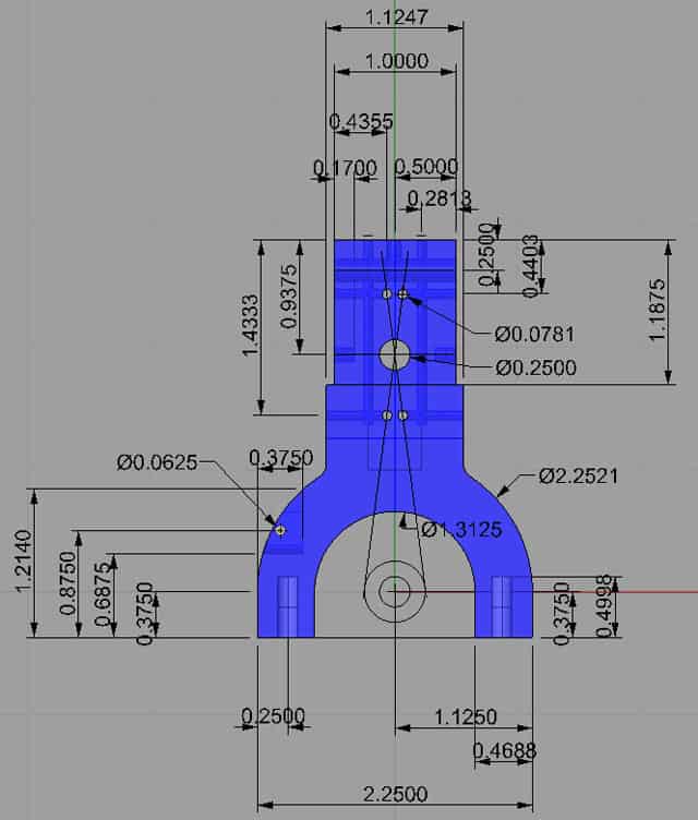

Column

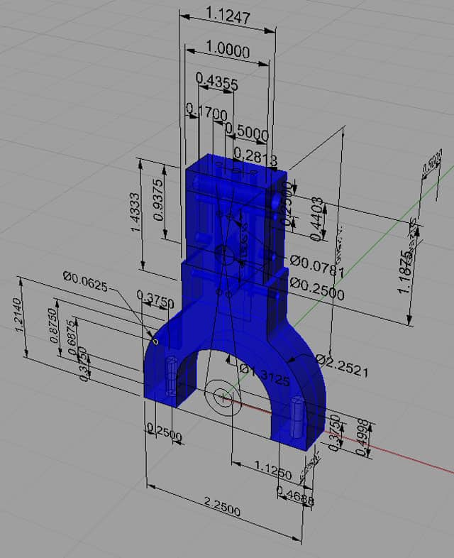

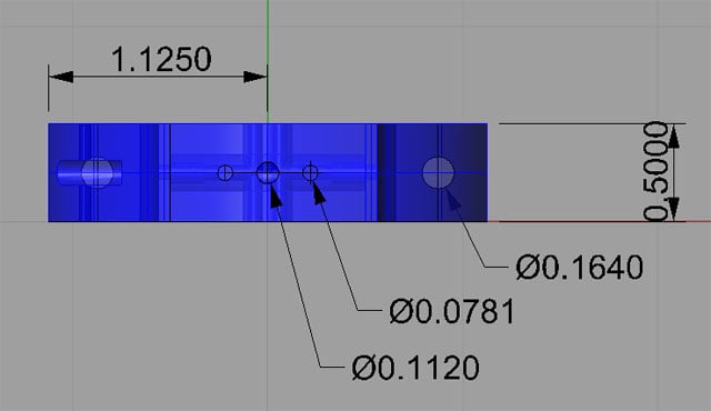

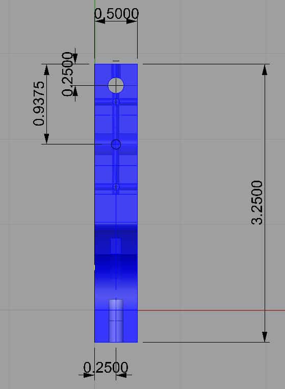

The column is the most complicated piece to machine because it has a number of features, holes, and curves:
Technical drawing of a column with blue 3D model and black text dimensions on gray background.
Perspective View...
Technical drawing of a column with precise measurements.
Front view...
Technical drawing of a column with millimeter dimensions.
Right view...
Technical drawing of a column, top view, with dimensions in inches.
Top view...
