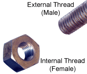

External vs Internal Threads
External male thread and internal female thread.
External Threads are screw threads whereas Internal Threads are the threads on the nut that goes on the bolt.  They'll have different measurements to provide a looseness that reduces friction and allows for manufacturing errors that are within tolerances.

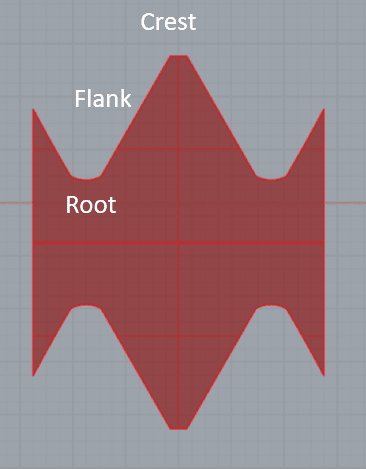

Flank, Crest, and Root
Wave crest and root with red shape and white text labels.
The Crest of the thread is the tip on top.  The root is the bottom of the thread.  Flanks are the straight sides that connect the crest and the root

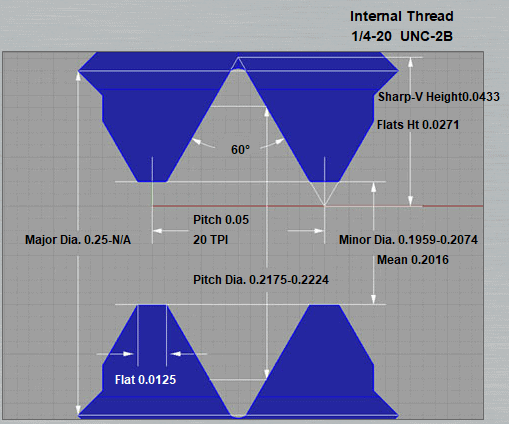

Thread Depth
Thread Depth is the difference between Minor to Major diameter
Thread Angle
This graphic from G-Wizard Thread Calculator shows a 60 degree thread angle:
Technical illustration of a thread profile with labeled dimensions.
