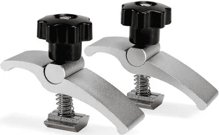

Hold-Down Clamps
These are similar to step clamps, but they’re more often seen on CNC Routers. The models shown are equipped with hand wheels. They’re very convenient but can’t produce as much holding force as the more normal screw-type fasteners.

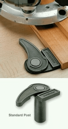

Cam Clamps
Cam Clamps are mostly seen on CNC Routers and other woodworking applications.
