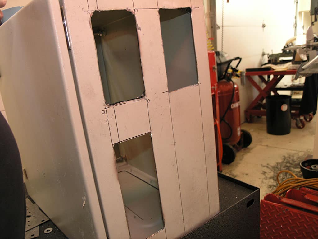

Cutting Most of the Cutouts in the NEMA Enclosure
I will still need holes for the cooling fan, but I want to make sure I understand the clearances and location of everything else before I try to position the fan. My current thinking is to put it in the door next to the hinge and up high to exhaust the warm air. Wish I had a louver punch!
Here are some piccys:
Partially disassembled metal device on black box.
The panel inserts cover the holes. 4 axes on front, with a master control panel at the top. I could possibly also exhaust the fan at the right side of that control panel...
Partially constructed metal structure in a workshop setting.
Three rear panel cutouts. Top 2 are for 2 more axes. Bottom will be for all the auxilliary connectors for limits, coolant relay control, and VFD control...
Two drills on a gray box in a workshop setting.
The cutouts were made by drilling a hole in each corner and then connecting the dots with an air nibbler...
A silver metal tool with a flat top and curved bottom, featuring sharp edges and a pointed tip.
The air nibbler has hardened jaws and went through the thick gauge steel box like butter...
