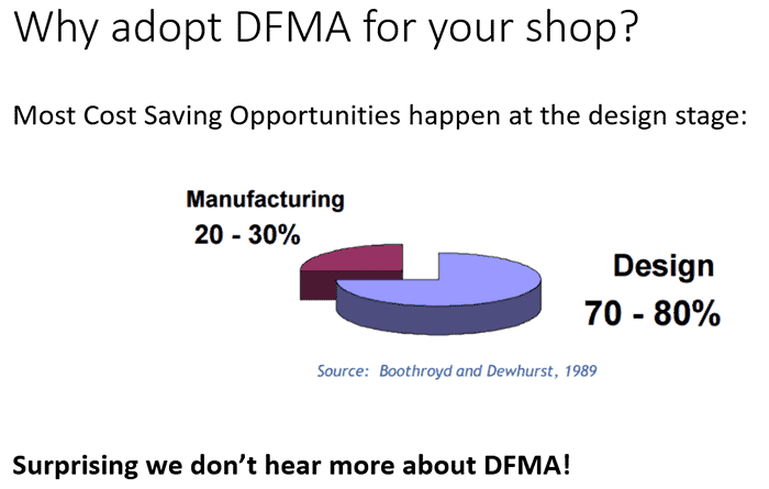

Critical Insight: Save Costs at Design Time
A pie chart illustrating cost-saving opportunities for adopting DFMA in manufacturing and design.
The biggest insight of the DFMA process is that most of the available cost savings are at Design Time.  It's not hard to understand why-making changes to CAD drawings is a lot cheaper than changing a manufacturing assembly line that's all tooled up.  That's probably an over simplification of all that's involved, but you get the idea.

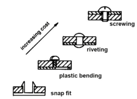

Another tenet of Design for Assembly / DFA is to reduce fasteners and use less expensive fasteners.  On average, fasteners are 5% of overall part cost but can be as much as 70% of the cost to assemble a part!
Here's an example of preferred fastening methods to reduce costs:
Technical diagram of machine shop fasteners: screws, rivets, plastic bends, and snap fits.

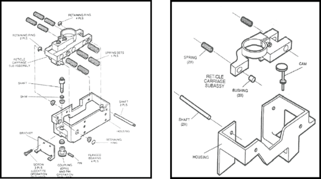

Here's a good example of the "before" and "after" of a DFA process for a part:
Technical illustration of springs, bearings, and shafts.
Notice how many fewer components are on the right.
A good benchmark is that a typical DFA process can reduce manufacturing costs by 25%.

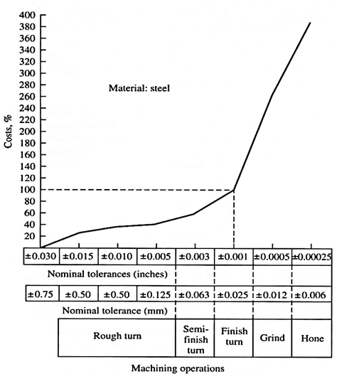

The High Cost of Tolerances
Most designers are shocked when they learn how expensive too tight tolerances can be.  Here's a simple chart that makes the point:
Material cost curve for steel with machining operations.
It's taken from our more comprehensive article, The High Cost of Tolerances, but you get the idea.  I have two takeaways for you about Tolerances:
  1. Don't over tolerance parts!
  2. Use GD&T instead of simple +/- tolerancing.
GD&T (Geometric Dimensioning and Tolerancing) is a more modern way of expressing tolerances than simple +/- tolerancing.  It can allow you to keep tolerances tight enough for part function while providing wiggle room that won't matter to function but saves cost.  I highly recommend our free GD&T Training if you're not familiar with it:
Check out the Free CNCCookbook GD&T Course today! ]

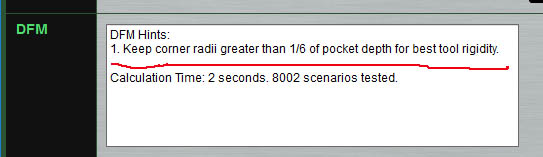

There are software packages available to help you-DFM Software, DFA Software, and DFMA Software are all available.
Our own G-Wizard Estimator (for job quoting and cost estimation) and G-Wizard Calculator offer DFM advice built right in:
DfM tip screenshot from CNCCookbook.com.
DFM Tips like this one for pocket depth are built right into G-Wizard…
If you haven’t tried it, go ahead, we offer a free 30-day trial.
