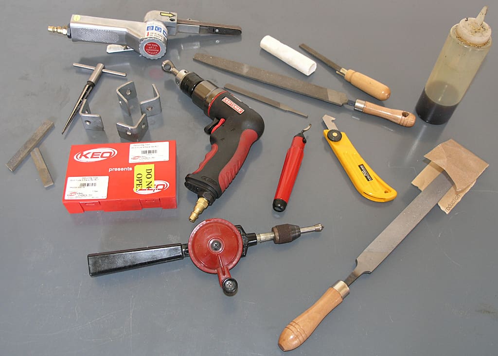

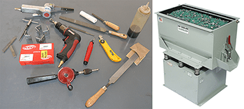

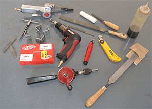

Manual Deburring is done by hand, possibly with the help of handheld power deburring tools.  Here's an assortment of the deburring tools that I use in my shop to remove burrs:
Grey surface with drill press, milling machine, and other metalworking equipment.
Let's go left to right, top to bottom and have a look at these helpful finishing products:

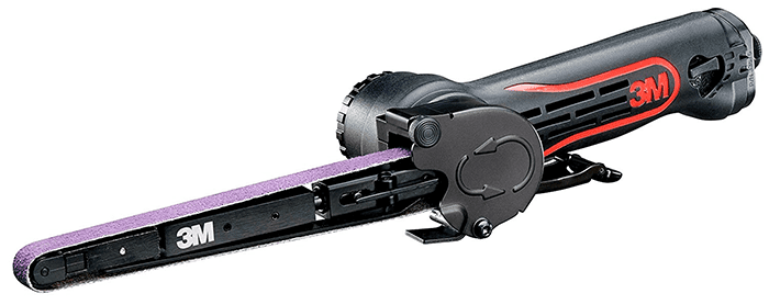

My favorite manual deburring tools are the handheld air-powered belt sanders called "air files" that are similar to this one:
A 3M belt sander against a white background.
They're really effective at getting into difficult spots, but the little belts do wear out pretty quickly.

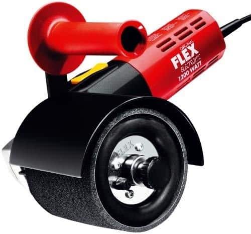

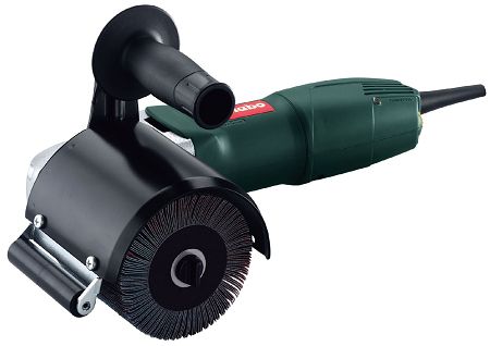

Metabo Burnishing Machine
Red and black Flex Satin Burnishing Machine with cylindrical shape and flat top.
Flex Burnishing Machine
These tools are German made and not exactly cheap, but they sure look handy.

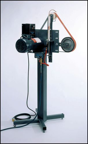

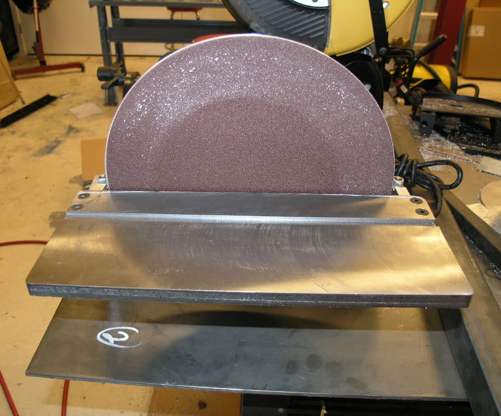

Stationary Disc and Belt Sanders
Stationary Disc and Belt Sanders of various kinds can also make short work of deburring jobs and rough edges.
Here's a 12" disc sander I built for my shop:
Industrial belt sander on workbench in workshop setting with surrounding tools and equipment.
Belt Sanders can be even more versatile for some jobs and come in a variety of styles:

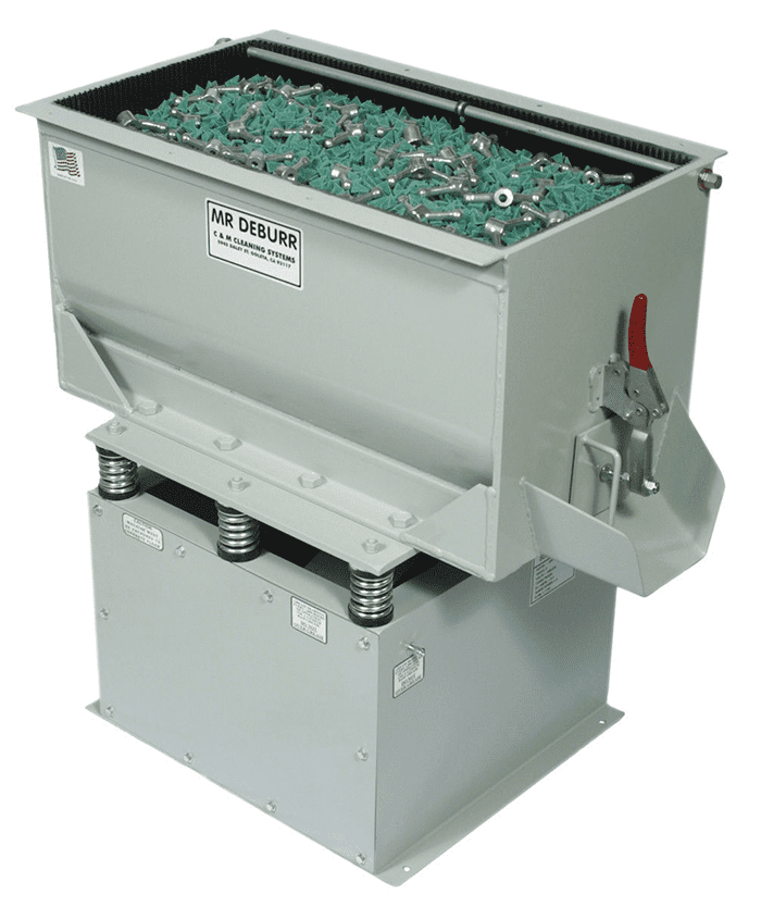

Vibratory Tumbler / Finisher / Polisher

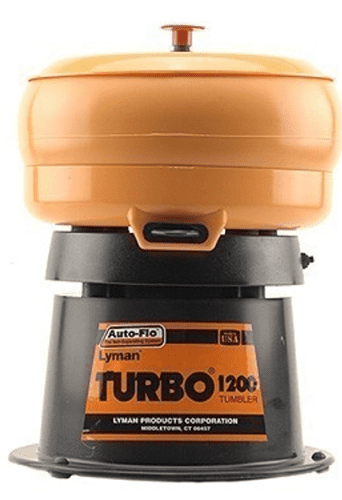

The most common mass finishing deburring tool is Vibratory Finishing.  Here, the parts and media sit together in a container that is vibrated to create motion and friction between the two.
Here's a smaller model designed for the firearms ammo reloading community:
Orange and black Turbo 1200 Tumbler device.
I've got one like that in my shop.  For commercial shops, much larger models are available:
Gray metal bin labeled MR DEBURR with screws, bolts, and washers inside.
These big models can remove burrs from a lot of parts pretty quickly.

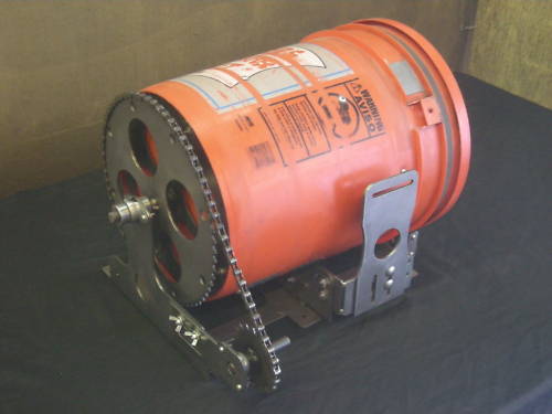

Barrel Tumbling
Another Mass Finishing process is Barrel Tumbling, where the parts and media are in a container that rotates along a horizontal axis.  This motion causes the two to tumble against one another repeatedly.

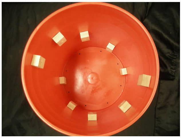

Here's a quick and dirty Barrel Tumbler made from a 5 Gallon bucket, plasma cut sheet metal with some folding and additional hardware thrown in:
Orange cylinder with black interior, chained, on dark gray surface against brown background.
It’s a pretty simple device.  Take a couple bicycle sprockets and some chain, a 5 gallon bucket, and some casters for it to roll in, and you have a part tumbler that can be powered by an electric drill.
Bucket has wooden blocks to make sure the is enough agitation.  Big sprocket is just bolted to the bucket to spin it:
Large orange plastic bucket with holes, used for tumbling parts.
If you don't want to make one of these from scratch, contact  Fred Nelson Fabrication.
They'll sell you a kit without a drill motor for just $169 and you're off to the races.

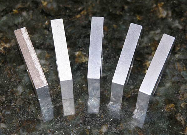

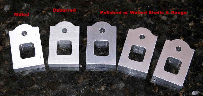

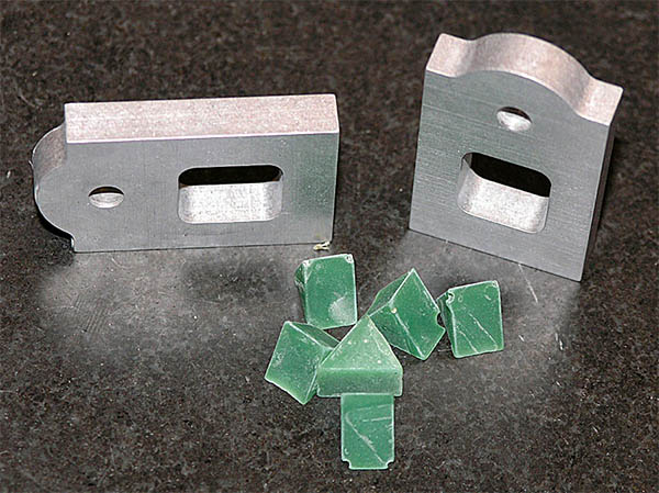

Here are some before and after pics of a little part I ran through my Vibratory Tumbler:
Metal parts with varying surface finishes on a black granite countertop, labeled Milled, Deburred, Polished w/Walnut Shells & Rouge.
Metal files arranged in a fan shape on dark granite.
The type of media used makes a huge difference.  I used the green media shown here:
Aluminum parts with cutouts next to small green plastic resin parts for deburring metal.
The pebbly finish is typical before polishing.
I used media from Grainger that was listed as:
Deburring Media, 3/8 Inch Styrene Triangles, 6 Pounds per Box, For 6A898 and 6A899
This media was recommended to me by a machinist friend largely because it was similar to what he uses (a 1" wedge shaped product from CandMTopline), but it was available in smaller quantities more suited to my small vibrating tumbler.

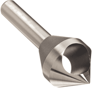

The most common means of deburring via CNC cutter is chamfering and corner rounding.  These tools are specifically intended to break the sharp edges the machining process can leave behind.  Pictured above are a collection of chamfering tools.  A corner rounding tool puts a radius on an edge:
Silver metal Corner Rounder tool.
Considerably more information on these tools can be found on our Milling Form Cutter page.

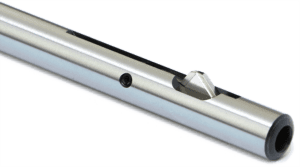

Hole Deburring Tools
Holes are the most common feature found in CNC work, so it should come as no surprise that there are special deburring tools aimed at deburring and improving the surface finish of holes.  Here's a typical "zero flute" style cutter:
Metal drill or tap tool with pointed end and cylindrical body.
There are even tools designed to deburr the back side of a hole:
Silver metal tube with threaded end and side hole.
Cogsdill is one of the more well-known providers of such tools.

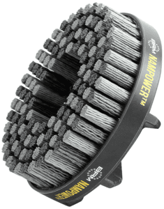

Abrasive brushes are also available that are designed for deburring when operated in a CNC machine.  Here's a typical model:
A black brush with densely packed bristles and bold yellow "MAPPOWER" text.
These abrasive brushes are available in a variety of styles.  They have abrasive grit embedded in stiff nylon bristles.

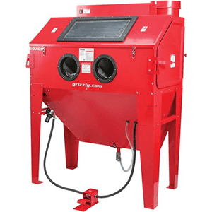

Abrasive Blasting can be done either wet or dry.  A stream of abrasive material is propelled by air and is focused on specific areas to deburr and polish the part.  Wet applications use a slurry with water as the liquid.
Abrasive Flow deburring involves extruding semi-solid material impregnated with abrasives through passages in the part.  It was invented for applications such as cylinder head porting.
A blast cabinet is a very handy thing to have for any shop:
Well-organized garage with air compressor, sandblaster, and air hose reel.
The blast cabinet in my home shop is pictured above.  You can run a blast cabinet with a variety of media to remove burrs, such as:
Your choice of media depends on a variety of issues including what finish you desire, whether the part has to avoid contaminated metallurgy (common in aerospace and medical applications) and what downstream finishing processes will be used.  For example, if you are working with aluminum and you intend to anodize it, the media choice has to ensure that it doesn't close the grain structure in the aluminum which is essential for the anodizing process.

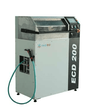

Electrochemical Deburring
In Electrochemical Deburring, a neutral-salt electrolyte flows through a gap between the tool or cathode, and the workpiece, which is the anode.  This dissolves burrs through natural electrolytic action.  This process can be very fast and can maintain precision as well.  The residue (dissolved burrs) are carried away and can be filtered from the electrolyte to allow its reuse.
Any areas that are not to be deburred can be insulated by non-conductive material to prevent the electrolyte from acting on those areas.
