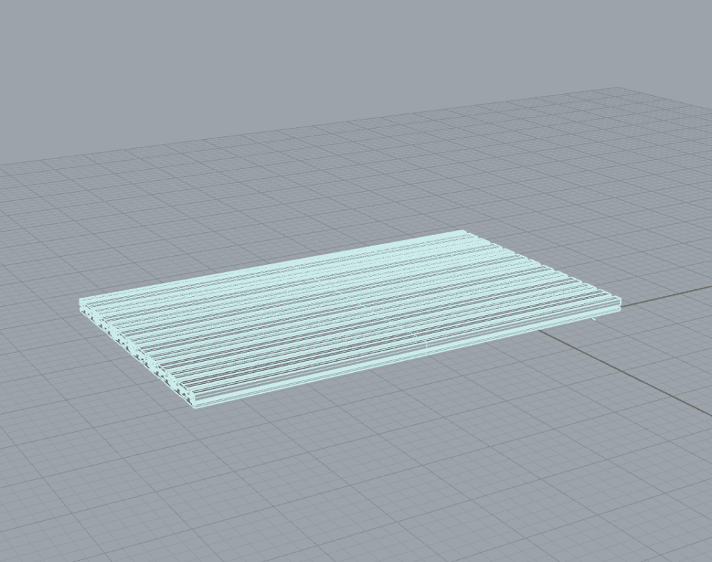

Table
CNC Router Tables can be made from a lot of materials.  Shown are aluminum extrusions set up to create T-Slots.  A router table might also be made of an expendable material like MDF.  In that case, if it is intended to be expendable and replaced when needed, it is usually called a spoilboard or wasteboard.
CNC Router Tables may be bare, but often they will have features to facilitate workholding.  For example, T-Slots, a hole grid, or a vacuum table are common.
Wood tops are sensitive to moisture.  In fact they can swell enough to cause accuracy issues for the CNC Router.  For that reason, aluminum, steel, or phenolic are commonly found on higher end machines.  A wooden spoilboard may then be attached atop the tough table below.

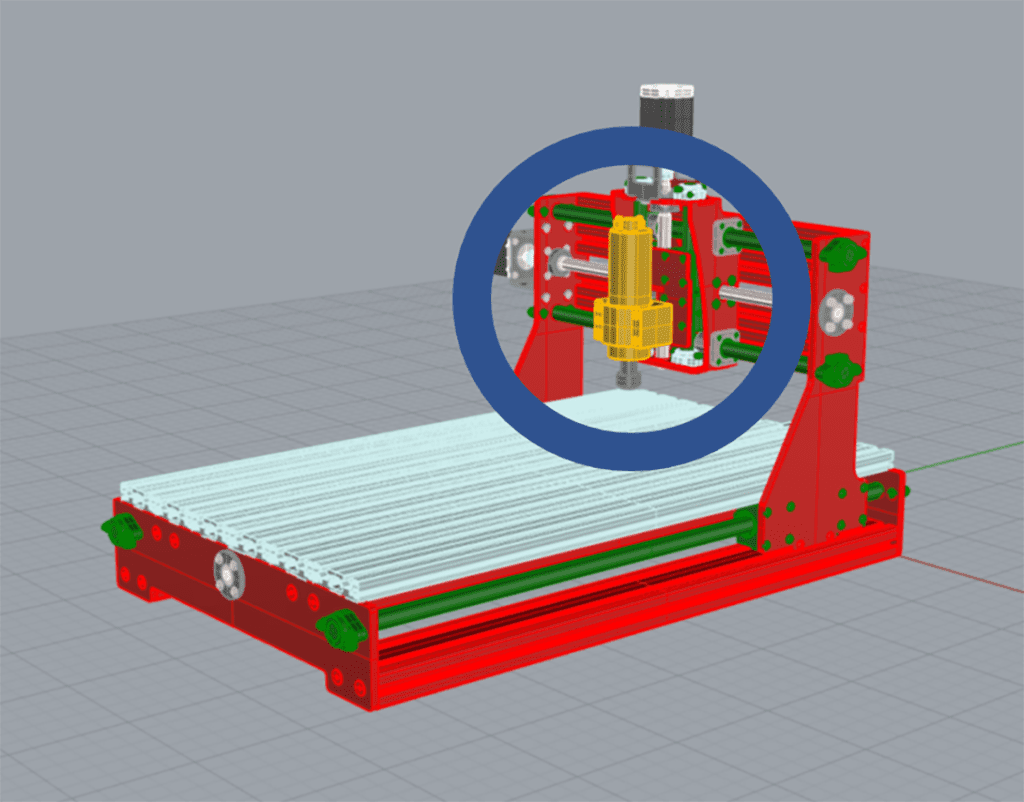

Red machine with green accents and yellow center.
Spindle
Some say the Spindle is the heart of any CNC Machine.  It certainly plays a major role in setting the performance potential of the machine.
At the low end, CNC Routers often use regular hand held routers or even Dremel-style tools as spindles.  A step up from that is a spindle with a VFD.  At the top of the heap are spindles set up for ATC-Automatic Tool Changers.

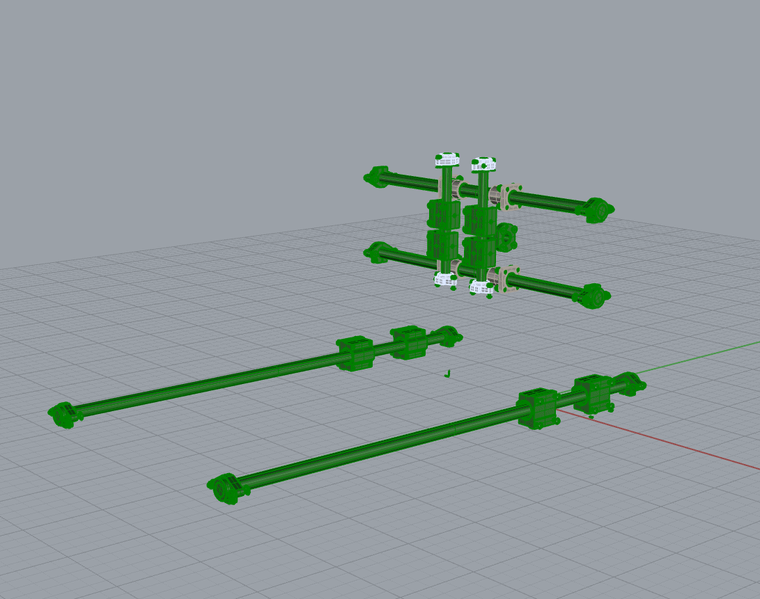

Green mechanical device with rods and joints on gray background with grid pattern.

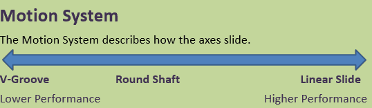

Ways
CNC Routers have at least 3 Axes.  An axis consists of some kind of sliding "ways" and a drive system that motorizes the axis under computer control.
There are several kinds of sliding ways commonly used for CNC Routers:
Blue arrows illustrating V-groove vs linear slide motion systems.
V-Grooves involve using ball bearings with wheels that often have a v-shaped groove in them.  These wheels ride on the edge of a rail of some kind.  The rail could be a triangular edge on an extrusion, or perhaps the edge of a piece of angle iron or something similar.  The groove in the wheel need not be V-Shaped, it could also be cupped, for example to ride on a piece of round shaft or a curved edge.
V-Grooves are the cheapest kind of sliding way, but they're also the least accurate and most prone to backlash.  The often require adjustment at frequent intervals for best performance.
Round shafts are what's depicted in our photos of a CNC Router.  They use ball bearings and can be quite a bit better performers.  The highest performance are linear slides, which have a prismatic shape and trucks that ride on ball bearings.

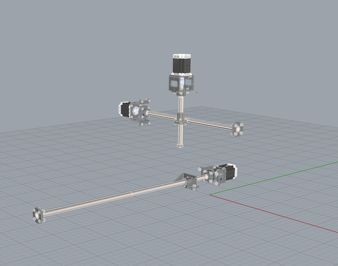

Mechanical device with multiple rods and components, against a gray background.

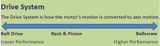

Axis Drive
The CNC Router's Axis Drive system converts rotary motion from a motor of some kind to linear motion to drive the axis on its sliding ways.
There are several common Axis Drive system in use for CNC Routers:
Belt drive conversion to ballscrew with opposing arrows on a green background.
When choosing your drive system, a number of factors must be considered:
We offer detailed articles on CNC Rack and Pinion drives and also on Ball Screws to help.
Also part of the drive system are the motors, and any drive connecting the motors to the rest of the drive.  Motors are most commonly stepper motors, but servos are a higher performance option.

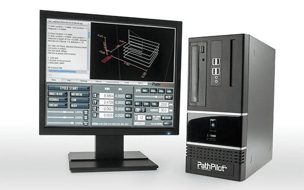

CNC Controller
A CNC Router's Controller is the electronics package that is responsible for executing a g-code programming and sending the necessary electrical signals to cause the motors to move properly to cut the part.
There is a wide variety of CNC Controllers out there for CNC Routers.  Pictured is Tormach's PathPilot, which is used on their whole line of CNC Machines.  It's quite powerful and easy to use.
Another very common controller is GRBL.  GRBL is open source software that runs on an Arduino single board computer.  It's UI runs on your PC.
Controllers can be largely single board without interface to a PC, single board with interface to PC (the UI runs on the PC), or based entirely on a PC with potential accessory boards for motion control.  There will also be a DC power supply to run the motors, drivers for the motors, and various other electronics for things like Limit Switches or spindle control.

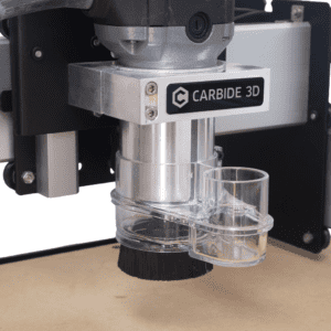

Dust Collection
CNC Routers are designed to turn whatever they're cutting into chips in a hurry.  In other words, they produce a LOT of dust.  So much, that cleanup is a problem.  Sometimes even breathing can be a problem.  The answer is Dust Collection.  Even a simple dust boot connected to your ShopVac will help tremendously.
The photo below shows "Sweepy", a dust boot that lets you connect your ShopVac to suck up the dust on a Shapeoko CNC Router.  They make Sweepy in sizes that correspond to commonly used trim routers.
Close-up of a silver metal component with a black "Carbide 3D" label.
For more on dust collection check out our detailed article, "Shop Vac vs Dust Collector: Easy Guide."

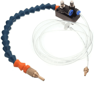

Misters and Coolant Sprays
If you plan on cutting aluminum with your CNC Router, you should invest in a mister.  Aluminum tries to weld chips to CNC Cutters, and the end result is a broken cutter wrapped with melted aluminum that looks like taffy.  Many will tell you they've gotten away with cutting aluminum without any form of lubricant, but it's a game of chance and the odds are against you unless you use a Mister.
It's pretty easy to buy or build a mist system for your CNC Router.  Here's our article describing a Coolant Mister I cobbled together from parts off eBay.
You can also buy one ready to go pretty darned cheaply.  Here's one for about $20 on Amazon:
Flexible air tube with black and orange hose and clear tube attached to an airbrush.
Add a coolant reservoir (I saw one made from a sports water bottle!) and feed it a little compressed air and you're up and running.

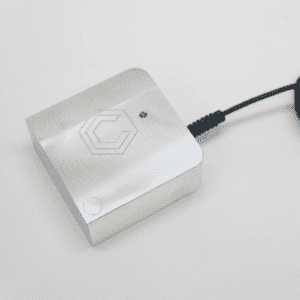

Tool Setters and Touch Probes
Small white device with black cord and circular indentation, set against a light gray background.
Shapeoko BitZero...
Automatic Tool Setters and Touch Probes make it easy to tell your CNC Controller how long your tool is and where you're parts 0, 0 coordinate is.  These are both things it needs to know before it can start cutting accurately.
Pictured is the Shapeoko Bit Zero.  Another great product is The Maker's Guide Triple Edge Finder.
