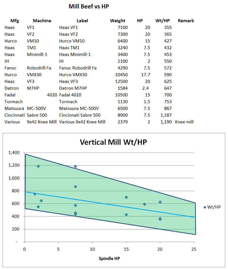

It turns out we can model their performance by looking at the amount of mass in the frame versus the machine's work envelope versus the spindle horsepower.  The work envelope is the total volume the cutter can reach.  A relatively lightweight frame can be extremely accurate if it only has to deal with a small work envelope. Alternatively, if spindle power is low enough, it won't be able to distort the frame as much.  These variables trade off.

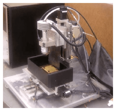

Here's a fascinating little machine that didn't cost much to build and is extremely accurate:
White 3D printer with black arms and dual extruder nozzles.
I've got an entire article about it, and if all you're interested in is engraving hobo nickels, it would be a lot of fun.  On the other hand, most of us want a larger work envelope for our projects.

I did this analysis of spindle power versus machine weight of commercial VMC's:
Machinists, engineers, and manufacturers with resources on machining techniques, metal fabrication methods, and CNC machines.
After further research, I was able to develop a feature for our G-Wizard Calculator that automatically de-rates your spindle horsepower (if needed) to the maximum your machine's frame can handle and still be in the low end of VMC rigidity.  It's pretty slick and has been especially useful for folks with machines that have rigidity problems.  I've had customers tell me their machines basically went from being maddeningly inconsistent to tame to suddenly being easy to use.
You might find the calculator is also helpful in determine how much frame you need or conversely, how powerful a spindle you can fit on your frame before it's too much.
