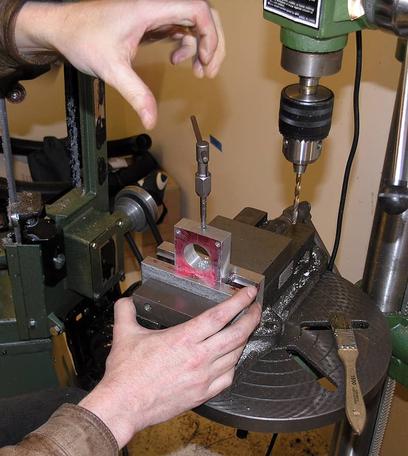

I did not thread into the banjo mounting shaft. Instead, I just used 2 set screws at 90 degrees. It was an easy couple of hours to fabricate the Z-axis mount:
A person carefully operates a drill press in a workshop setting.
You can see the mounting plate here. My brother is threading for one of 2 set screws...
Metalworking lathe component with red cylindrical body, silver plate, bolts, screws, and wires.
Here's what it looks like on the lathe. Very sanitary, no? It's on there to stay as well!

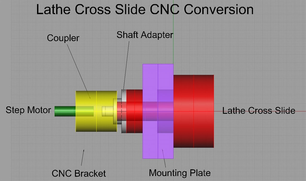

So, I will build a square plate with holes for the shaft, 3 mounting bolts to the lathe, plus the 4 NEMA-spec mounts for the motor spacers. BTW, they're hard to see in the picture, but there's a nice little thrust bearing on the shaft underneath the round piece as well as the one that's visible on the shaft. Together, I'm sure they contribute to the nice handwheel feel on these Lathemasters compared to cheaper Asian lathes as well as getting rid of backlash due to axial movement of the leadscrew. Here is a cutaway view of how it will all work:
Lathe cross slide conversion to CNC machinery with labeled components on a gray background..
The mounting plate captivates the first thrust bearing as well as providing the attachment to the cross slide base via the 3 allen head bolts. The leadscrew shaft protrudes through this plate, and there is a shaft adapter. Since the leadscrew is bored and tapped, the shaft adapter serves two functions. First, it reduces shaft diameter to better fit our helical beam coupler. Second, the adapter presses against the thrust bearing so that by tightening the axial allen head threaded into the leadscrew against the adapter we take up any axial play in the leadscrew. You can see the shaft adapter a little more clearly if we take away the CNC Bracket/Motor Mount:
Cross-slide CNC conversion mechanism with step motor, coupler, and other mechanical components.
That red disk between the shaft adapter and the mounting plate is one of the thrust bearings.
