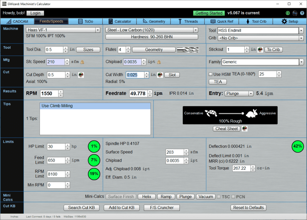

In cases where you need to reduce the chip load to improve surface finish, G-Wizard also includes a built-in rubbing warning to keep you out of trouble:
I want you to notice the two areas I've flagged with a red rectangle outline.
On the right, you see G-Wizard's "Tortoise-Hare" slider. It moves cuts from most conservative (full tortoise) to most aggressive (full hare). The most conservative position is calibrated to be the slowest you can feed without rubbing. It's handy, both to know where the limit is, but also to get the nicest possible finish. We'll talk more about the Tortoise Hare and Finishing vs Roughing Feeds & Speeds soon, but I wanted to get that out there.
Now I manually reduced the feedrate further after setting it to the Fine Finish position, so now we are rubbing. And you can see the lefthand red rectangle shows a warning message that these settings may cause rubbing. If you use a tool like G-Wizard, you won't have to worry about rubbing much because the software is looking out for you.

Let’s try an example based on doing some peripheral (edge) milling to profile a part made out of mild steel using a 1/2″ uncoated HSS 4 flute endmill. We plan to take fairly shallow finishing quality cuts of 5% of the cutter diameter. Further, let’s do a pretty deep cut axially, a full cutter diameter of 1/2″. So if I am profiling a 1″ high part, I can make a full pass by going around twice and cutting 1/2″ each time.
What feeds and speeds should we use?
The Niagara page says for cuts less than 1/16 of a diameter (5% is 1/20), we want 210 SFM and a chip load of 0.0035. If I plug all that into a calculator and use the standard formulas taught in most shop classes (which ignore chip thinning), I get the following results:
- Radial Depth Ratio of 5% = 0.025″ depth of cut
- 210 SFM and 0.0035 chip load gives us 22.46 IPM feed rate and a 1600 rpm spindle speed.
Is that the right speeds and feeds?
Yes and no. It’s certainly what the majority of folks would use. In fact, they might even be less aggressive than that if they’re trying to be conservative.
Let’s see what G-Wizard would suggest by default and why:
- For the same depth of cut and cutter, G-Wizard wants a little slower SFM of 203, and the same chip load at 0.0035.
- The spindle speed works out to be 1550 rpm due to the lower SFM, but the feed rate is now 49.778 IPM.
That feedrate is over 2x the conventional values.
