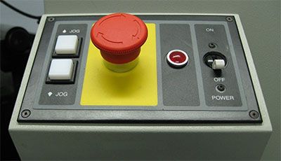

Be ready to press the E-Stop
Deliverable: Be prepared to push the E-Stop before the program can get into trouble.
Industrial control panel with red and white buttons.
Before any run, I always look carefully for where the E-Stop button is located. I reach out and touch it, mimicking the motion I will make if there is a problem. If my hand will be on the FRO, I start there and act out the motion of moving my hand from FRO to E-Stop. I close my eyes and visualize that motion too, several times.
Sound crazy?
I am just trying to make sure that if I have to press E-Stop, there'll be no fumbling for it. I want my muscle memory to know exactly what to do without having to stop and think about it.
Note: On some machines Feed Hold is a better choice than E-Stop. This is because it can be easier to get the program restarted after a Feed Hold than an E-Stop. Make sure you know which one is best and that it will always stop what's happening as soon as possible.

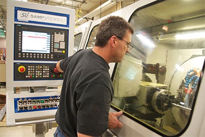

Watch as the Program Cuts Air
Deliverable: Having watched the Program Cut Air, you'll know whether it's ready to make chips.
Man in black t-shirt standing beside window looking at machinery and computer screen in a machine shop.
Before you even start to run the program, look at the backplot display on your controller. Are there any unexpected moves? Does it look like the correct program you expected?
If it all looks good, you're ready to cut air. At any point during a run, the operator can press the Feed Hold in order to stop progress and check on something. For example, if you know every tool is exactly 2" above the work when cutting air, you could use Feed Hold and a 1-2-3 block to check tool height after each tool change.
