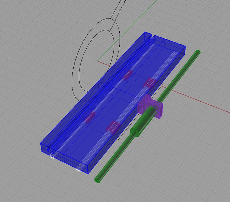

Conceptually, this seems a straightforward project, so I dove in with Rhino and made some trial drawings of what it might look like.
Rhino Concept Drawings
Blue CAD rendering of rectangular shape with green tube on gray background.
Here is the basic concept...
The table is made of 1" thick aluminum, probably 6061 although 7075 (Fortal) would be better. Ideally, the aluminum should be fixture plate and already ground on top and bottom. It is 18" long, and set up for 10" travels. These are the same dimensions as the Omniturn gang lathes use.
A single T-slot runs along the front edge, and is used to mount the tool holders. I am envisioning tool holders similar to what Omniturn uses. They look easy to make. I would set their dimensions so the dovetail on the toolposts is identical to AXA's, which makes it possible to use my existing holders or buy new ones so they aren't all custom.
The rails are mounted to the underside of the tooling plate so they are fully supported. The roller trucks bolt to the top of the apron. Because of this, I think I can eliminate the need to machine the dovetail, which makes it possible to restore the lathe to manual operation and sell it if desired. I will need to work out a procedure to align the blocks so the slide moves perpendicular to the ways with sufficient accuracy.
The ballscrew shown is a 5/8" from McMaster-Carr that drives the slide from the side. An overhead sheet metal cover would be fabricated to protect the screw from swarf and coolant. I envision L-shaped brackets at the ends of the ballscrew with the slide moving unobstructed through the "elbow" of the "L", and the bearing blocks for the ballscrew integrated with the L. These brackets will be mounted to the front and rear of the apron.

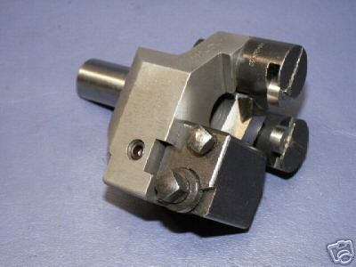

When I bring up the idea of gang tooling on the various boards, there is usually a strong reaction against the loss of tailstock functionality. I recently came across a thread where the Widgitmaster suggests a Box Tool provides a good alternative to the tailstock:
Metallic component with cylindrical protrusion and threaded hole against a gray background.
Box Tool with Support Rollers...
A box tool is much like a follower rest and toolholder integrated into one assembly. Seems like it would be worth thinking about. The workpiece end would need to be small enough to allow the rollers to engage before cutting begins. I'm not real sure how the rollers are tensioned onto the workpiece either, but its worth some research.

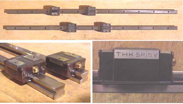

After looking at costs for new slides, I put in a bid on a pair of used THK SR15V linear slides for this project and won! For the record, the new slides I looked at were from McMaster-Carr ($751.52 for an unknown brand), Technico ($394, THK SRS series), and Automation4Less ($189.49, HiWin). Hopefully they show up in good condition. They're a little beefier than some of the new slides I looked at (which means they're bulkier too!), but I got the 2 rails and 4 trucks for $127.50.
Linear motion components: two rails, two carriages, and one THK SR15V guide rail on a wooden surface.
THK SR15V Linear Slides...
Here are some specs from THK, and I was also able to download some DXF CAD files so I can be dimensionally accurate in my design.
Specs
Height (Track bottom to truck top): 24mm
Width: 34mm
Length: 40.4mm
Radial Dynamic Load: 5.39 kN = 1,211.7 lbs
Radial Static Load: 11.1 kN = 2,495.3 lbs
Reverse Radial Dynamic Load: 3.34 kN = 750.8 lbs
Reverse Radial Static Load: 5.55 kN = 1,247.6 lbs
Side Dynamic Load: 3.02 kN = 678.9 lbs
Side Static Load: 4.77 kN = 1,072.3 lbs

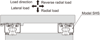

Here is THK's recommended installation configuration for maximum rigidity:

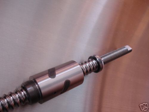

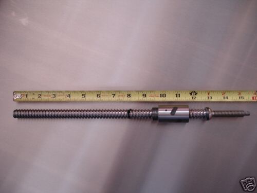

Schneeberger Precision Ground Ballscrew
Another eBay find contributed to this project:
Silver metal threaded rod with spiral design and central nut.
Threaded rod with ball-nut assembly.
This is a nice compact precision ballscrew with a travel of approximately 10", which is spot on with what I'm looking for. The unit arrived looking brand new. It was lubricated with a thin coat of oil and moved very smoothly. It's going to take a little bit of thought to see how to mount it, but my current thinking is that I will produce a sleeve with an ID thread to fit the end and loctite it on. A nut on the remaining threaded portion will lock my bearings in place.
