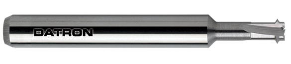

I decided to write this article after seeing Datron's excellent blog post on a couple of their combination tools, so it's only fair I include them here and give them some recognition.  First up is their combination milling and thread milling tool.  It's an endmill and threadmill in one:
A combination cutting tool with milling and thread mill features.
Combination Milling and Thread Milling Tool...
The endmill consists of just the bottom or end part and not the full flutes, though there is a little bit of helical cut away as you can see.  It's good for plunging and interpolating shallow holes after which you can thread mill a thread into the hole.  Compared to using 2 tools, Datron claims a 65% time savings with this little gem.

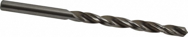

Drill Countersink
Of course we are all familiar with a Center Drill for lathe work, which is nothing but a combination drill and countersink.  There are many more combinations and sizes available, however.  Here is a [drive matic drill and countersink](https://drive matic Drill Countersink):
Silver drill bit with spiral flute and square drive.
These are most commonly used in through-hole applications.  You can also get countersink collars for regular twist drills that let you set the depth of the countersink relative to the point of the twist drill.

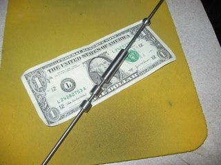

Turning a small diameter piece that’s long and skinny is difficult. The piece is going to want to bend and flex and generally make it difficult. Imagine trying to work this piece, for example:
A photograph of a dollar bill being held by a metal rod.
That long skinny piece would give me fits!

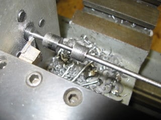

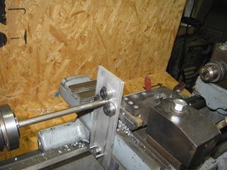

Steady rests and follower rests were made to pick up where the support a tailstock can lend is not enough. Most lathes come with these gadgets, and most folks don’t use them often enough–I know I certainly don’t. Part of my problem is I have the usual cheap Asian brass tipped units, and I just can’t feature that brass riding very happily along the workpiece. It has been in the back of my mind to add some ball bearings. I’ve got a ton of cheap skate bearings floating around the shop that should be perfect for the job.
The fellow that did the dollar bill piece above came up with a solution when turning that piece:
Metal lathe mounted in front of an OSB wall panel.

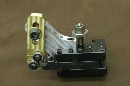

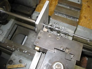

Frank Ford, whom I’ve mentioned here before (be sure to visit his awesome site!) has a mini-follower built right into a QCTP toolholder:
Small metal component with screw and holes.
Shopmade box cutter?

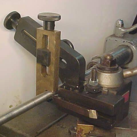

Here’s another version, the one I think Frank said he modeled on, that you may be able to purchase from King if you don’t have time to make one:
Metalworking tool with screw and clamp.
The only thing I don’t neccessarily like about the QCTP mounted versions is your tool has to be square onto the workpiece. For some operations, that isn’t the case, so I think mounting one to the carriage as in the first example might be a little more versatile.
