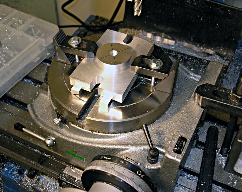

1 - Rotary Table
You forgot to provide the text you would like me to rephrase. Please input the text and I'll be glad to assist you.
That circular boss is the first thing I made with a rotary table on my manual mill. It was so many years ago I don't even really remember doing it. Just imagine how much trouble rotary tables where. You had to get their axis dialed in for the center of your feature. Then you cranked that handwheel, and potentially had to read off some degree angle too, for example, if you wanted to radius a corner and not make a full circle.
We used big drill bits so much more often just because big round holes were a lot of trouble with a rotary table. With a CNC, interpolation is easy and happens constantly. Radiusing corners is effortless.
We do sometimes see inexpensive 4th Axis setups made from Rotary Tables, so they are sort of with us for CNC, but not like the old manual days.

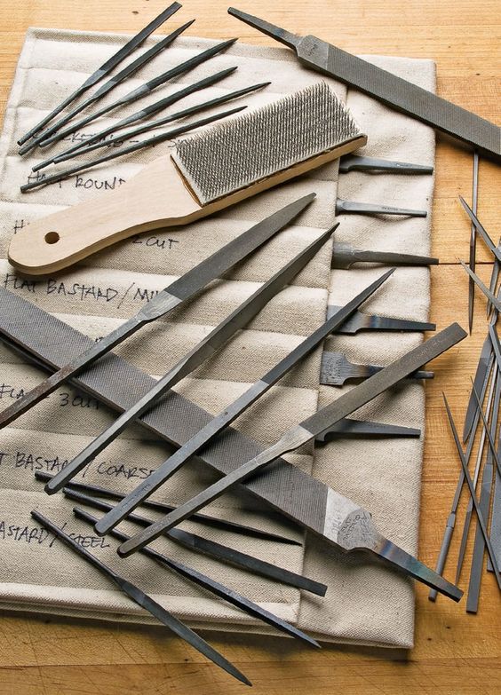

2 - File Work for Chamfering
Don't get me wrong-file work is by no means obsolete. But it ain't what it used to be. Mostly, it seems nice for deburring with CNC, and often a file isn't the best choice there either. But look at a nicely CNC machined part and you'll see they've chamfered most of the edges. One of the easiest ways to chamfer the edges is to just program in a chamfering tool in your CNC program.
No way did that happen on a manual machine! If the edges needed breaking, a file was a quick tool at hand. In fact, there were many operations that were just easier with a file. Machinists were trained to do high precision file work too. I wonder how many can do that kind of work today?

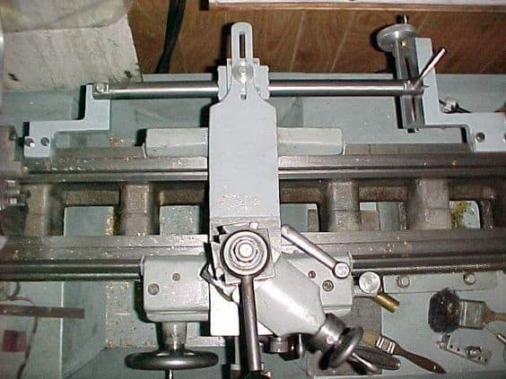

4 - Taper Attachment
Tapers are a staple of turning work, but they have to be done right. Cut your taper at the wrong angle and it can be useless. Any good manual lathe therefore needed to have a taper attachment. They work as a sort of tracing guide. Set the attachment at the same angle as the taper you want to cut. Attach the lathe's cross slide, and as the slide moves right to left, the taper attachment will move it in or out to mimic the taper being turned.
Similar tracing attachments were available for mill work too, and these were logical precursors to CNC that a lot of parts were made with. The fancier models were hydraulic, and amazing things could be accomplished.
Remember all those fancy turbine blade demos you've seen with 5-axis CNC?
Well, there were jet engines and turbochargers way back in World War 2. And those parts were often made with tracers.
With CNC, programming any arbitrary taper is easy.

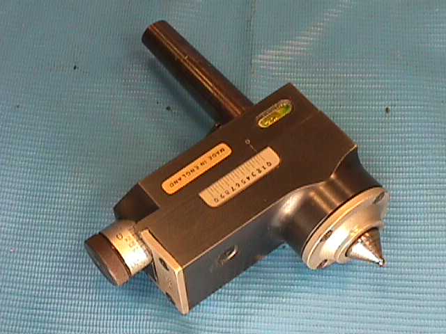

5 - Tailstock Taper Attachment
The alternative to the tracer-style taper attachments was a tailstock taper attachment. I've shown pictures of a very nice shopmade one as well as the one Royal used to make back in the day. They have a fine screw to adjust the taper.
By turning between centers with the tailstock end being off-center, a taper resulted.

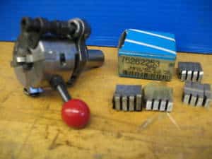

6 - Tailstock Die Holder and Geometric Die Heads
Speaking of the Tailstock, there used to be many different accessories for them. They were not strictly for workholding, they were also the place for various cutting attachments that had to work on-axis.
A tailstock die holder is a great example. The first part I ever made on a machine tool was a tailstock die holder I made on my first small lathe. The one pictured above is very nicely made and I'd be embarrassed to show mine alongside, but I used it quite a lot.
Faster, fancier, and more oriented to production work were Geometric Die Heads, also installed on the tailstock.
These days, it is so easy to program virtually any thread into a CNC that putting a die head on the tailstock seems quaint.

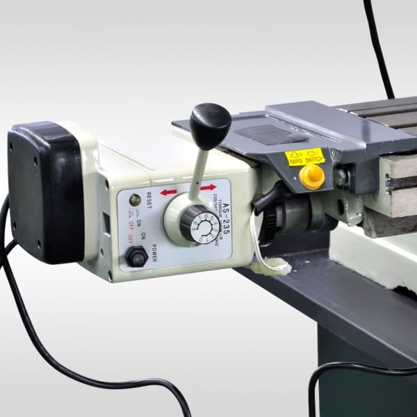

9 - Power Feeds
While some manual mills can be had with power feeds from the factory, most of the time these are add-ons. Of course CNC machines by definition have power feeds.
In fact, I am fond of saying that by mastering just a few g-codes and MDI, any manual machinist can run a CNC and it will function just like the manual mills they're used to. People who think manual is faster for certain things have to consider that used like that, a CNC is just like a manual machine with power feeds and DRO's on every axis.

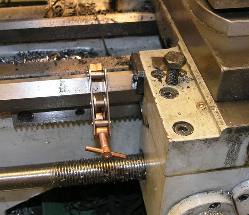

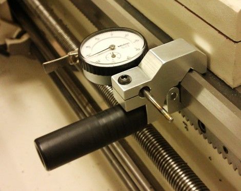

11 - Lathe Carriage Stop
Carriage Stops, with or without the dial indicator, are a popular accessory for lathes and are often shopmade like this one. When manually feeding the lathe, they let you set up a cut you'll be repeating so you stop at the same place every pass.
With a CNC, this is all a matter of your program. Bye bye, carriage stop!
BTW, in a pinch, I have used a Kant Twist as a carriage stop (and as a vise stop). They work great and the brass feet protect your lathe's carriage from any marring:

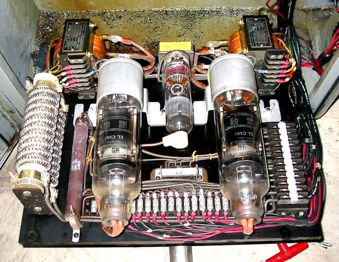

13 - Fancy Thyratron Speed Controls vs VFD's
That Mori Seiki bit got me thinking about fabulous old lathes. For many, the Monarch 10EE is the pinnacle of achievement. It used this fancy speed control that has an exotic tube called a Thyratron in it. The goal? Be able to turn a knob and have continuously variable fine control over spindle speed.
Today, we have cheap VFD's to do the same thing or at the higher end, we use servos to drive the spindle. Purists restoring 10EE's work hard to come up with working Thyratrons any more. Those who just want the pretty lathes to work retrofit modern VFD's and servo drives to them.

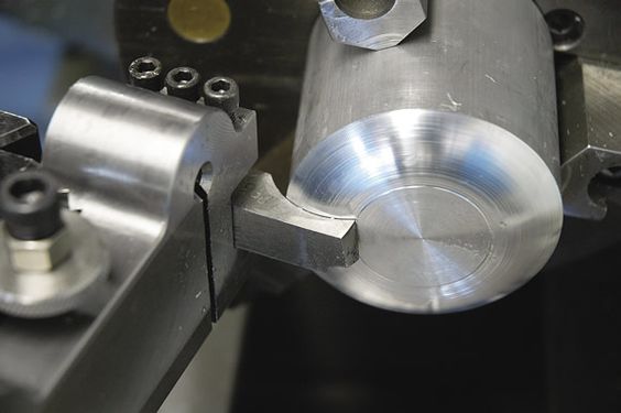

14 - Form Tools
Back in the day these were another great shortcut on lathes. If you were handy with a tool grinder, you could put whatever shape was needed and cut the whole curve in one fell swoop. Sure, the thing could be a real chatter monster and had to be carefully tended to. The one in the picture has a special tool holder that springs back, for example. But you could cut a radius like the one shown very quickly.
Today, we just program that profile into the CNC and it gets done quickly and perfectly every time.

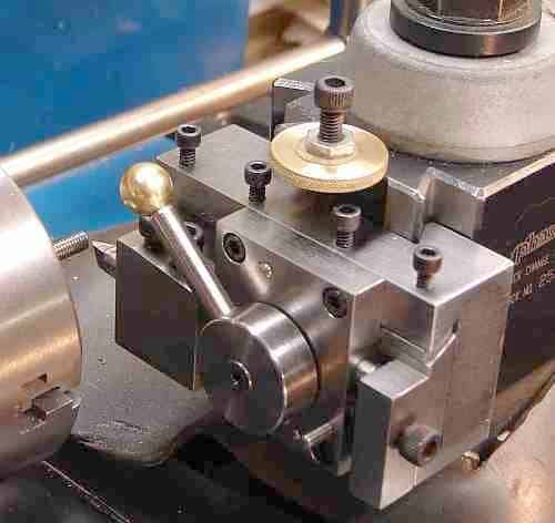

15 - Retractable Threading Tool
Threading is best done with multiple passes, and to do that quickly and precisely requires some help. Fancier lathes have nifty gizmos built right in to do the job of retracting the tool just right each pass. But the alternative is a shopmade retractable threading tool like this one.

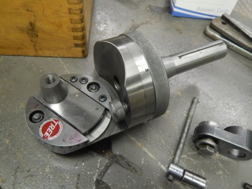

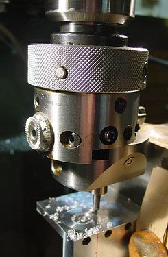

Bonus #16: Automatic Boring Head
Back in the day Wohlhaupter, Tree, and others made these fabulously intricate devices called Automatic Boring Heads. They had mechanisms that would increase the diameter being cut each pass automatically while still maintaining precision. Tree's could even cut a tapered hole.
While I am not going to say boring heads in general are obsolete for CNC, they are typically going to be used to finish a hole that was mostly cut via interpolation with an endmill. And, if you know what you're doing and have a decent CNC, you can be pretty precise without a boring head at all. A couple of the tricks:
- Calibrate based on the acceleration your machine is capable of. This can be measured via trial and error test bores, but exceeding the ability of the machine to accelerate the axes is probably the biggest reason for inaccurate interpolation. Our G-Wizard Calculator can help compensate for this.
- Interpolate both clockwise and counter-clockwise. The Conversational CNC Hole Wizard in G-Wizard Editor has an option for this and it will clean up a world of hurt.
If you need the very best precision and surface finish, you may still wind up using a boring head on a CNC, but for most jobs it won't be needed. Just in case, here's our article on Boring Heads for CNC.
